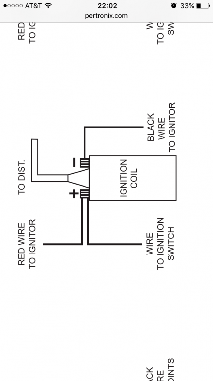

I use the petronix coil I just paint it black. I use switched 12 volt side of ballast resistor to the coil.
Just like the picture. Super simple. Tachs fine.
Petronix 1 you use the ballast . Petronix 2 and 3 ballast is by-past. I run the Petronix 1 in the 65 and my 67 Dart both tachs work fine.Dart is going on 20 years now.I use the factory mopar coils.Maybe go over the instructions again to see if you missed something ?
I bypassed ballast as per instruction sheet, I bet that's the problem
