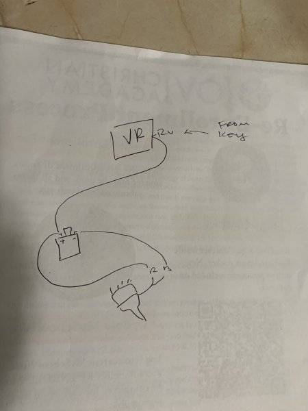

I had pertronic ignition added to my stock distributor for my 1969 383.
I need to provide 12v switched power for the red lead to distributor.
Where should i get that on the firewall.
I see that there is switched 12 volt at both sides of ballast resistor and at voltage regulator
Red wire to coil +, black wire to coil -. Bypass the stock ballast resistor.
Morning
Feed both the coil and distributor from the switched side of the voltage regulator. Take the black from the distributor to the neg of coil. And that’s it. Do not ground as it will bring down the voltage. Pertronix needs the full 12 volts to function properly. Delete unnecessary wiring to clean up the bay a bit
thanks
Just for a visual
