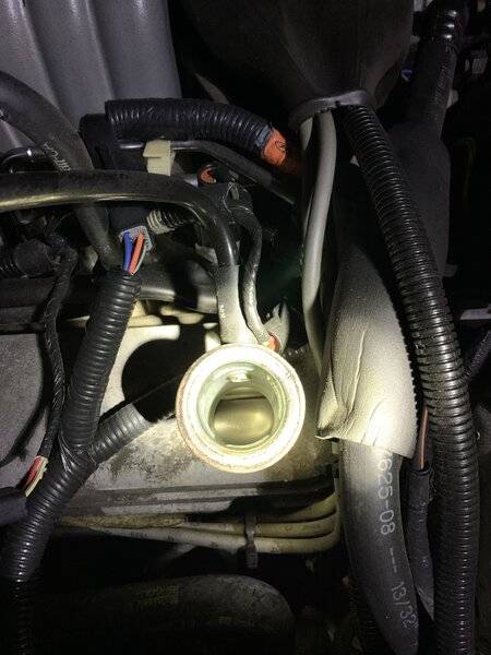

After that we took the oil cap off and it looks like the engine has never ran in its entire life...

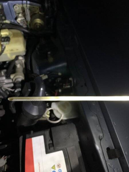

The dipstick however is confusing. There is oil all the way up to the "full" mark BUT only on half the width of the dipstick?!? (See picture)
There are no metal flakes / glitter in the oil on the dipstick interestingly.
But i expect some in the oil pan anyway...
