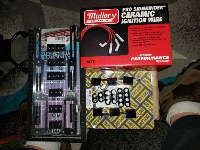

I hate plug wires running all over the place. These should do the trick and work OK with the Proflow 4 electronics and TTi headers. Plan to use the polished loom holders along the valve covers ans loop the plug wires over the header tubes. Hope to be done tomorrow, we'll see.

Nice. I used 2 sets of the Taylor wire looms on the Coronet. Keeps it tidy.
At one time, I bought the organizers on the left in your pic and although they were very well made, once installed I found them basically "in the way" of accessing the plugs below (I have Hedmans, not the nicer TTI's).
They sure look pretty installed, though.

Currently i have the 90deg plug caps from an MSD kit on the spark plugs, which, IMO, cause the wire to be stupidly long and routing them back up is a PITA without them hitting the headers.
I think i will go for long straight plug ends, or the long 45deg as shown on the box in your pics, not sure which one you are going to use?
For you it will be a nice addition because that block looks damn good already!
Those plug caps steer the wiring away from the header nicely!
Currently i also have red wiring but i think i will go for a black colour next time because that silicone absorbs all greasy fingers that touch them and are not easy to clean. (apart from with chemicals)

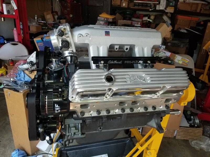

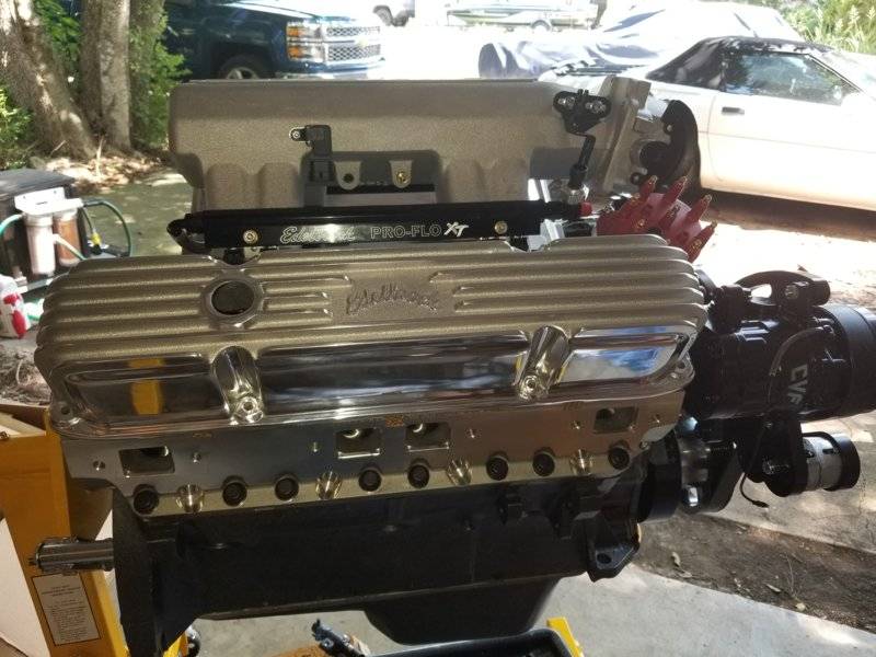

ok Tmaleck, you have added to our appetites. tell us a little about the engine and especially the intake and throttle body. is the aluminum runner from R&M? Just really curious.
thanks
PT in Tennessee
Gladly. it's a 73 440, forged crank. It has Wiseco forged true street flat top pistons. Rods are stock 6 pack. Both were balanced. Comp cams nostalgia plus cam, PRW stainless rockers. Sidewinder aluminum heads with 78cc chambers. CVF black serpentine kit with compressor and power steering. 440 Source SFI fluid damper. The intake and distributor are part of the Edelbrock Proflow 4 XT with 90mm throttle body. Plug wires are Mallory universal spiral core with 135 degree ceramic boots. Wire looms are R&M billet. Lots of trial and error, I may post a build thread down the road.
