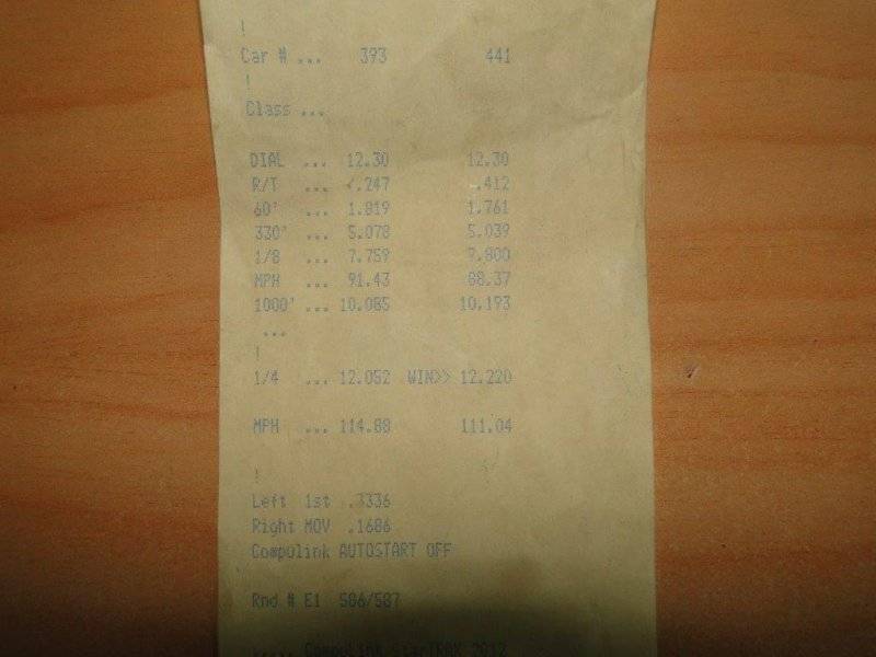

So two years on I finally got to go to the track. Same combo as before but changed the crank for a new scat forged crank. I opened up the port runners and trimmed down the guide bosses myself, had a 30 degree backcut done on the intake valves and added some 1.6 mancini arms. 4.1:1 gear and 275/60r15 ET Street R's. Seems the 60 needs work. Any advice. Car# 393 left lane. DA was around 1000ft.
Yep the 60' is lazy for the time.
So, you dialed 12.30 and ran a 12.0??
Yes, was running 12.3's with a 1.95 60ft, the last run I let the tires heat up more so that it dragged the engine down on the burn out. Just getting a feel for the car at the moment.
Ok yes you have to go out repeatedly many times to get a grip on what the car is capable of, before dissecting what its not capable of.
