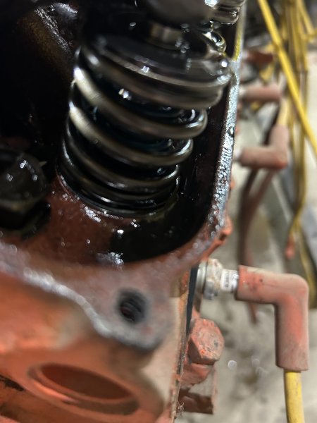

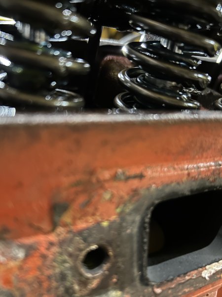

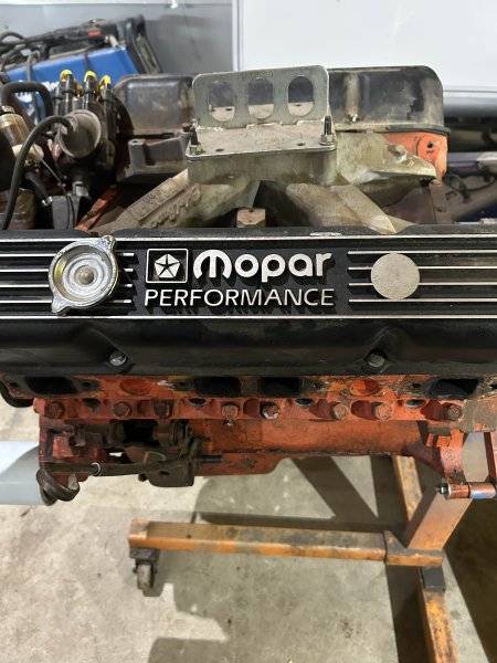

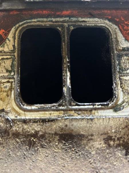

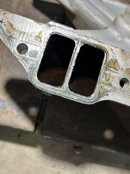

These were built 30 years ago. I knew they were ported and polished. But I didn’t know the ports were coated in a black or dark blue epoxy type coating? The intake is totally coated inside. Must be some kind of an old racers trick? Kim
The color isn’t really showing up for me, but I’ve seen it where the dye in race gas will stain an intake manifold.
Try a little carb cleaner and scotchbrite on it, see if it comes off.
If there’s epoxy in there, maybe the fuel dye stained the epoxy.
can't anything in the photos
seen something as you described, don't remember it being blue
could just be a dye they added
usually when they went too far in a port, needed to smooth the transitions
or a hole
supposedly now they say
the rougher grind like 80 grit, from the polishing tools/drums
makes more power
then a glass smooth port did

Exactly, if it were some trick that was done in the past, it isn't practed anymore. But I cannot see what is described in the pics so, it is possible it was staining from fuel etc.
I know an engine builder that coats the inside of blocks with a red, I assume some kind of epoxy.
