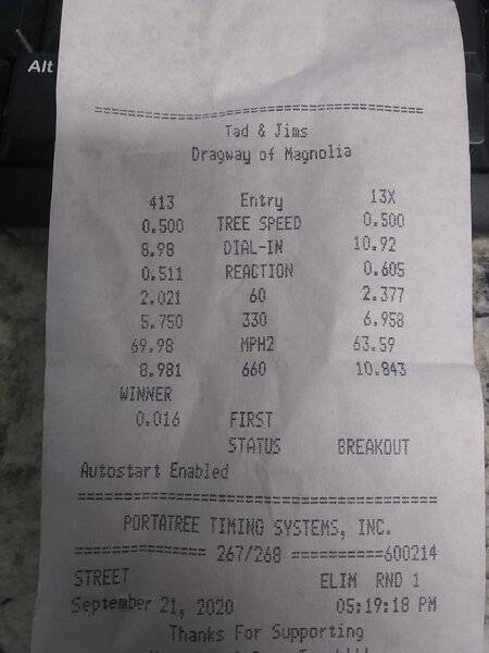

I was in the left lane. On my only time trial I fried the tires on the starting line, so my dial in was a guess.
.511 light, I knew was closer than I should be and red lit in round 2.

I made 3 trips to the track since getting this thing tuned back up.
Made around 15 1/8 mile passes, launching at 3500, shifting around 5500.
The engine ran good and gave me no more trouble.
It's slower than back in the day, about .6 seconds slower in the 1/8 th.
I won street class with it Sunday, but the last couple passes the clutch wouldn't hold in 4th, so I am calling it a season.

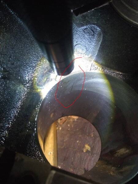

The more serious issue is a crack in the #8 Cylinder wall. It's about an inch long on the outside bottom, under the piston travel.
I have had a little coolant get in the oil, off and on at least as far back as 1994. Just a little bit, most notable when it sat over the winter. I put some Moroso engine sealer in it, seemed to stop it mostly.

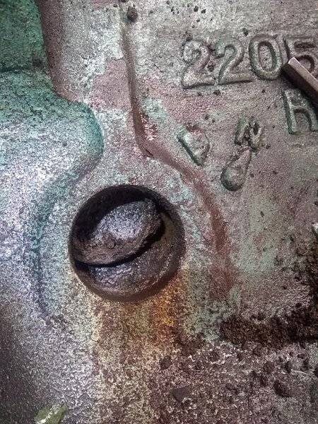

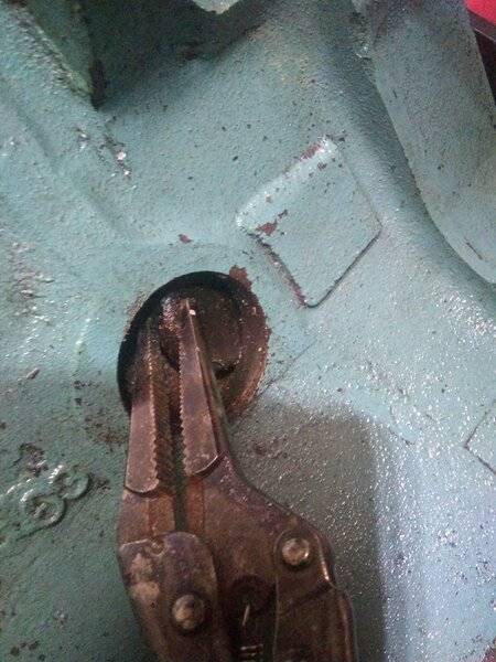

I took the freeze plugs out today, and wouldn't you know it; the jackass that R&R'ed the freeze plugs for me left the old one under the new one. The coolant passage is packed solid with gunk. I'm fairly certain this is the cause of the crack.
So stuff like this is the reason I can't stand to have anybody else work on my equipment.
Is it a crack? Or a scratch? That big a crack would've been putting a fair amount of coolant in the oil. I suppose unless the coolant passage behind that area was plugged solid. On a budget? Turn the 413 crank to 400 main size and build the 400 you have.
Doug
Pretty sure it's a crack, there was foamy crap at the bottom of the cylinder and discoloration of the wall. I had to blow the crud out of the cavity to get the pick of the freeze plug.
