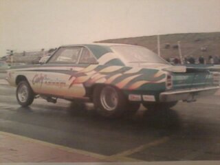

I like many, spent years trying to build a 'Budget street/stripper' and in the end I just went and bought a done car!
I saw it advertised and like many others were ''wondering what the catch was''?
The guy had spent 100 grand, yes a 100 grand on 'running EIGHTS' with his Dart.
After he ''blew everyone away'' he hung up his overalls and helmet and gave the car away...:wtf:
So me and a Mopar-mate bought the Dart and put a 452ci (all iron motor in) and ran a 10.40...:praying:
We was a little upset cos that motor had run a NINE in a similar Dart...:soapbox:

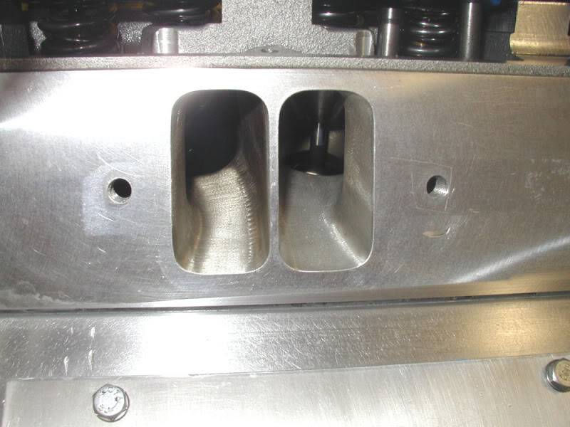

Don't waste your $$ on iron heads!! Many cheap aluminum heads flow much much better right out of the box:thumbsup:

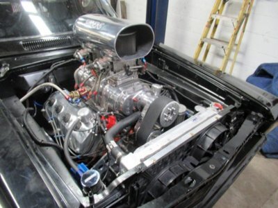

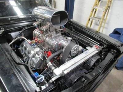

I'm sure we can all run tens with 'one of these' lol
