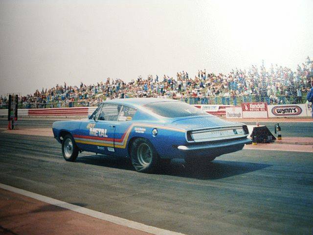

Sorry if I've posted this up before, not going through 41 posts, so here it is again?...back in 1989>
1969 446ci Cuda, back halved
Stock CR 440-6 motor. -040 fel-pro's so 9.8:1?
BV 906 heads (260cfm?)
850DP, Team G dom intake+ adapter
2" f/wells
CC. .650/.650", [email protected] SFT cam
HS r/rockers, battleship springs with small spring removed
Milodon s/line external oil system
727 fmvb, A1 4800 stall, f/brake
8.3/4" w/35 spline strange shafts/spool
4.88's, 14x32's (4psi in those days:()
L/bars, c/overs
90/10's
approx weight@line 3280lbs, all steel apart from hood, tin work
only made 1 run NA, 10.71@125 then hit with a small shot to go 9.96
had 10.5's in it with more air in tyres and calm front down but that was then.
