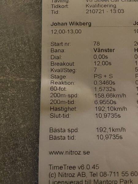

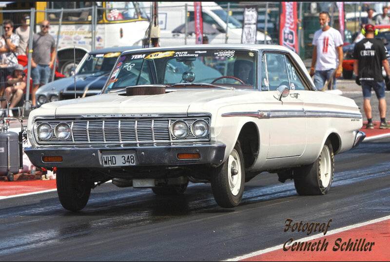

Holy f**k never thought i would be writing in this thread... after many years of running 14 to mid 13 sec runs... But with a new mill it went 10,97!
My Combo
1964 Plymouth Sport fury
Stock steel body, glass, bumbers all stock!
Suspension: Superstock leafsprings
Rear: Dana60 Detroit locker 4.10 gears
Transmission: stock ’68 TF727, Billet servos, bolton sprag, Cope valvebody, Custom made 10” converter
Engine: 440 source 440/500 stroker, 4.15 stroke
Untouched Trickflow 240 heads (too small to make real power)
Crane iron rockers 1,6 ratio
Untouched Trickflow Track heat intake
Brawler 950cfm race carb
Cam: Howards solid flat tappet
260/264@050, 0,656/0,661 lift (with 1,6)
Dyno at 607hp@5300 (valvefloat) have changed springs but not dynoed after.
890Nm of Torque more or less from 3K until 5300. 12EF90ED-605A-4965-9ABC-62BFF4EDFFAF.jpeg

If the Trick Flow 240 heads are "too small to make real power", what would be big enough to make "real power"?
And............what then would be "real power"?
Trick flow heads all come CNC ported to my knowledge so yes the 240 heads can make nice power and do in many combo's. Ron
