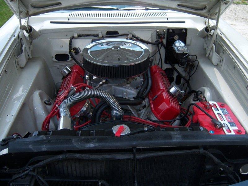

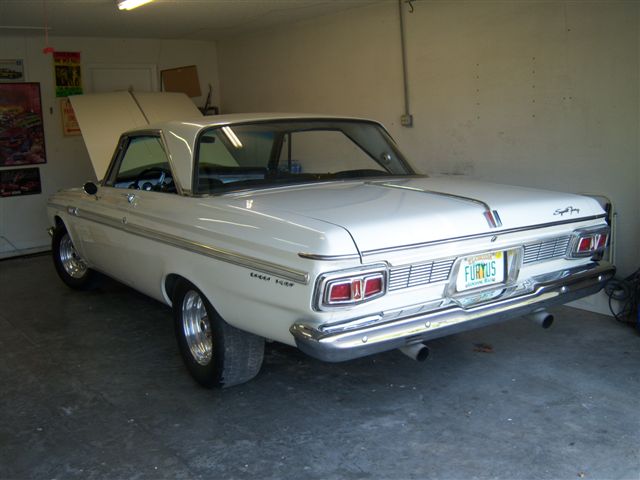

Which trw pistons?
It's been a long time since I built the engine. But, they are the low compression stock replacement pistons. 9 to 1. From what I've read these are actually lower than that. I had the heads cut .030, and the intake side of the head was cut to keep intake alignment.
Furyus - I ran the same #s bang on with my 64 Polara,, 440

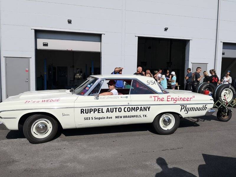

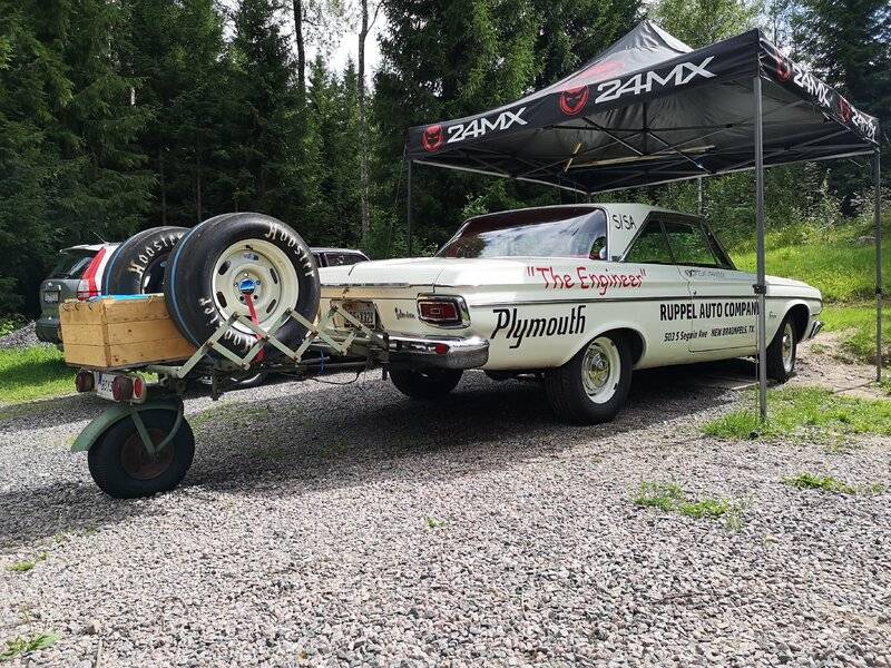

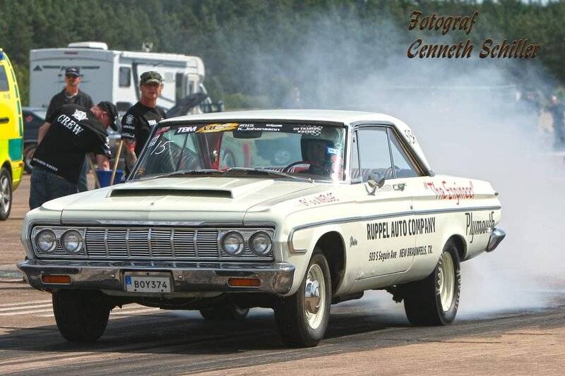

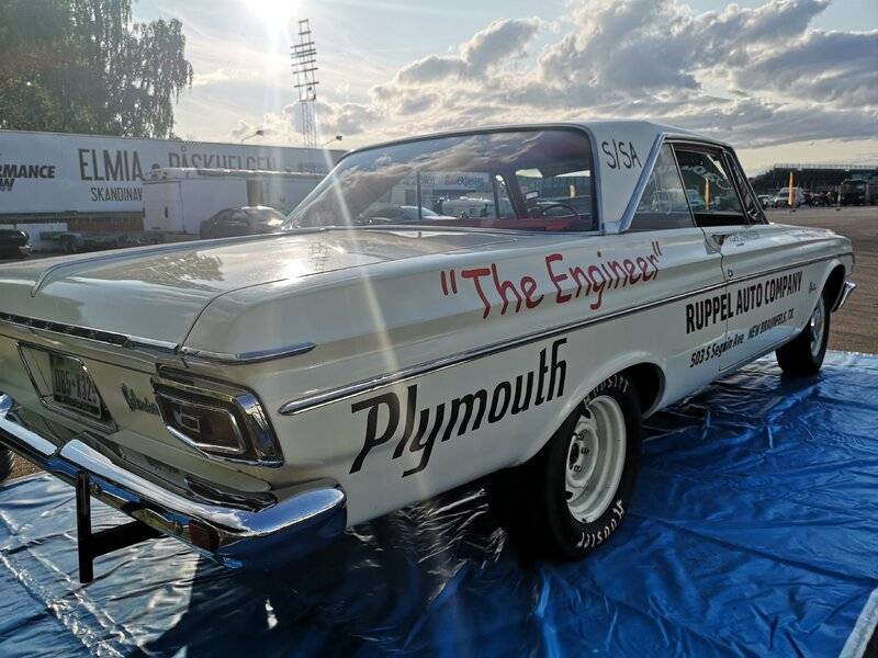

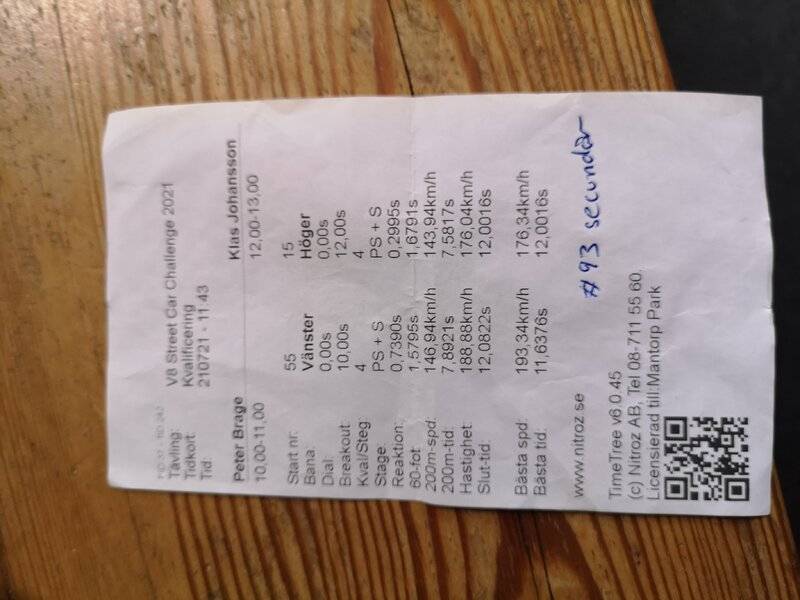

Changing the camshaft from a hydraulic comp cams xe284h to a hughes solid stl5054bs3-08,resulted in better et's.
Best with the comp cam
12.248@108.4 60' 1.74
Best with solid hughes cam
12.0016@109.4 60' 1.68
Same track both runs and good traction.
Still feels slow after 5000rpm, thought this issue would be solved going to the solid cam, but it was not.
Next up is to swap the old mopar electronic dizzy for a msd pro billet. Hope this will fix the issue.
IMG_20210718_153017.jpg IMG_20210720_095600.jpg IMG_20210720_191455.jpg IMG_20210721_195819.jpg FB_IMG_1626978061043.jpg

Laying down at higher rpm, especially with a solid cam, is most often weak valve springs.
