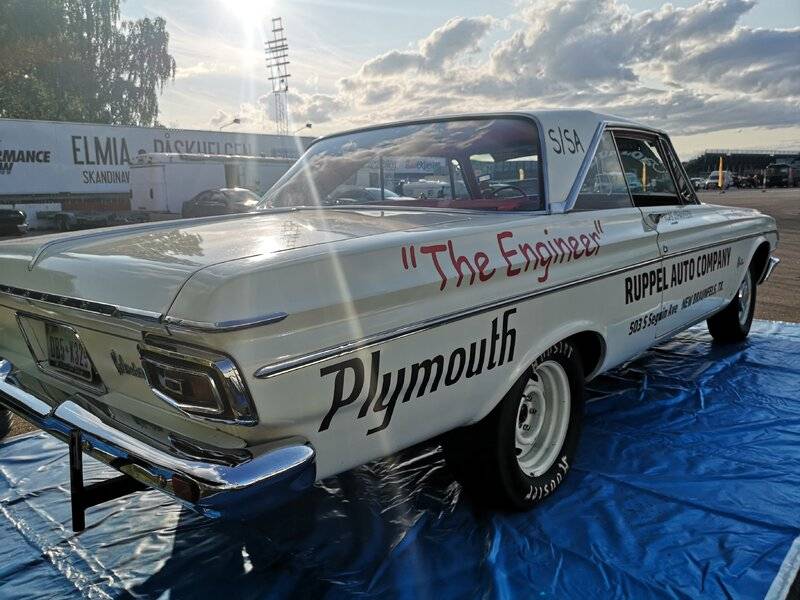

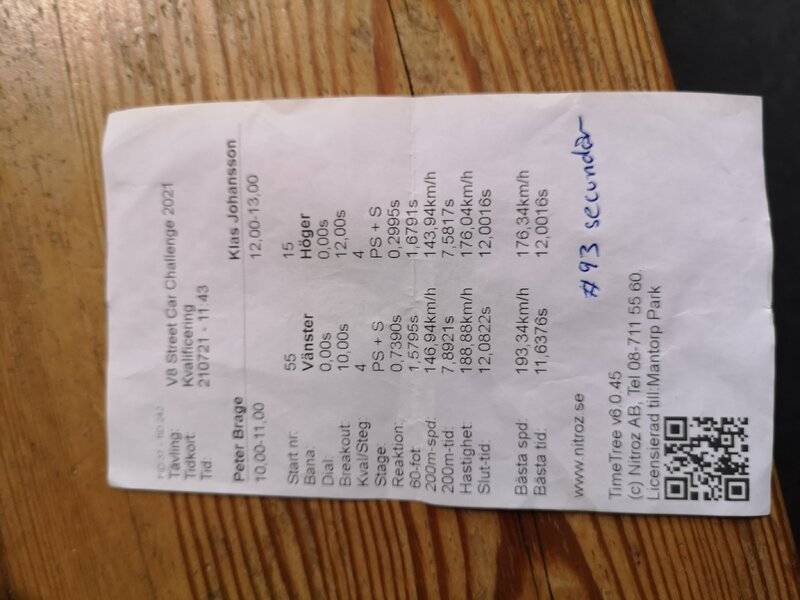

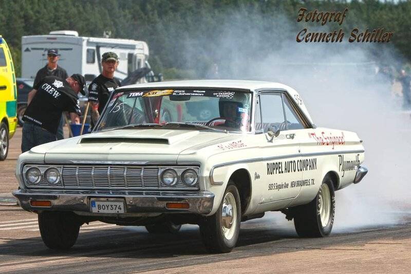

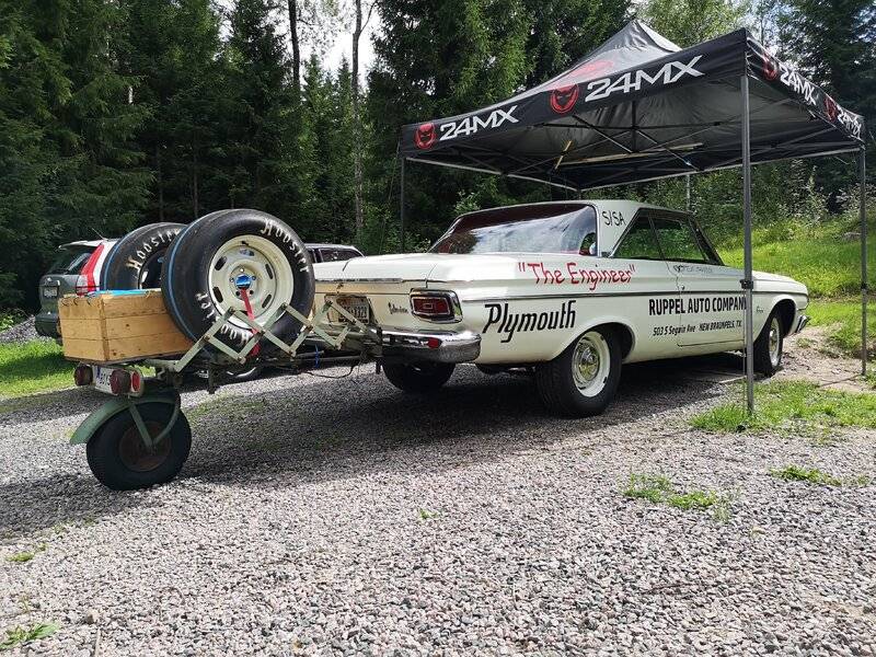

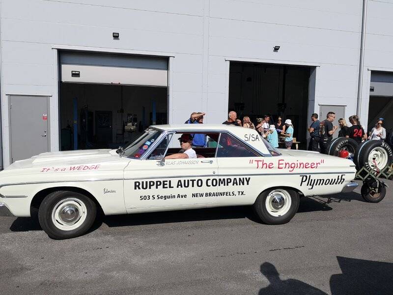

Changing the camshaft from a hydraulic comp cams xe284h to a hughes solid stl5054bs3-08,resulted in better et's.
Best with the comp cam
[email protected] 60' 1.74
Best with solid hughes cam
[email protected] 60' 1.68
Same track both runs and good traction.
Still feels slow after 5000rpm, thought this issue would be solved going to the solid cam, but it was not.
Next up is to swap the old mopar electronic dizzy for a msd pro billet. Hope this will fix the issue.
View attachment 1173594 View attachment 1173595 View attachment 1173596 View attachment 1173597 View attachment 1173598
Looks like you are prepped for Drag Week?

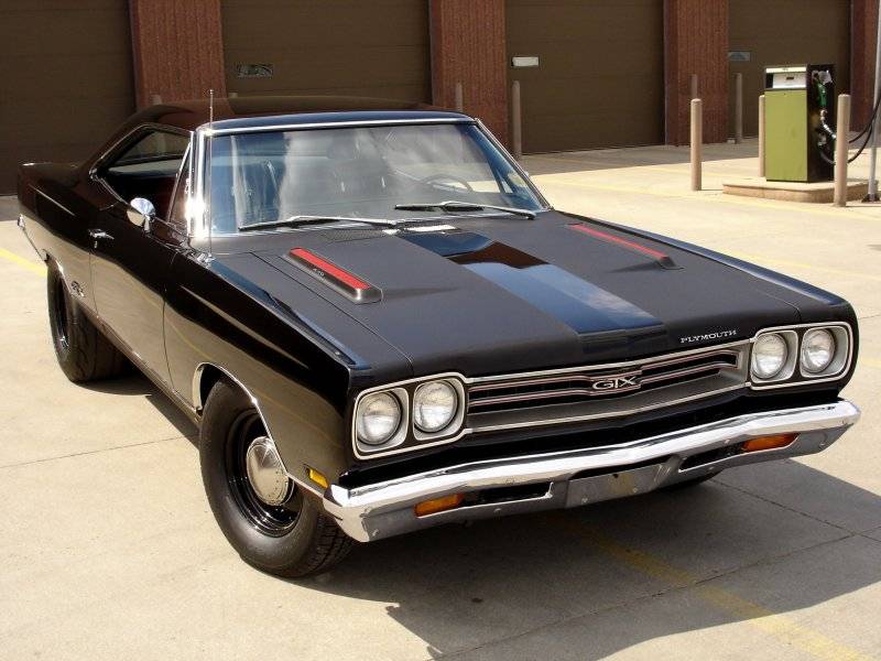

I’ve had the GTX for almost 43 years and never had it on a track. Reading through this thread I believe it would run in the 12’s, any guesstimate on what it might run?
Full interior, about 3800lb with driver and a half tank of fuel
440 +.030 with TRW flat tops 10.4:1 calculated CR
Ported 906 heads
.509 cam
Hooker 1 7/8” Super Comps
Full 2.5” exhaust with a crossover and Flowmaster Delta 50’s
Gasket matched CH4B with a JET modified 750 DP and Carter HEMI fuel pump
Mallory YL with MSD6AL box
727 with MVB and billet aluminum drum
9.5” Dynamic converter (flashes to around 3700)
4.10 Sure Grip
3800lb SS Springs and adjustable snubber
90/10 front and 50/50 rear CE drag shocks
295/65R15 MT Drag Radials
On the street it launches hard and buzzes to 6K with ease…
Edited to add a picture since everyone likes pictures

Looks real nice!
