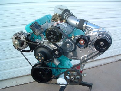

It's a blow through carb. I gave them my engine specs and they designed the kit, which included the cam. I'll go with the electric vacuum. This is a pic from their website but it's the same kit.

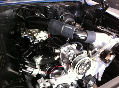

The 7/8 bore is a standard size? I'd rather have the manual brakes rather than the noise from the pump. Hope to start plumbing fuel system this weekend.

I still use my power brakes with my good size flat tappet cam that is 264 & 270 @ .050 and .630 lift with my 1.6 rockers and it has a 110 LSA. You can see the brake booster on my 63 is pretty big and will store alot of vacum. I can get 2 good hits on the pedal but anymore then that and the pedal starts getting hard. But most normal driving I dont hit the pedal more then 2 times in a row before I go again and build more vacum in the booster. I was actually surprised how well the worked. But with a smaller booster they may not work as good. As was stated you can get an electric vacum pump if you think you need it. Ron
