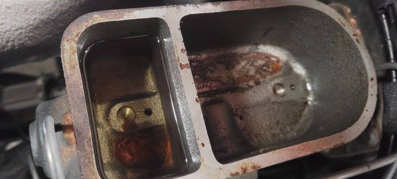

Someone converted my 66 Coronet years ago to front disc, with a kit from SSBC Brakes.
As far as the calipers and rotors they look good still. Car has the original rear drum brakes -- which I've overhauled.
I've found rust in the master cylinder. Tried to clean it out but I cant get all of it and definitely don't want any remnants.
Ive got a 440 under the hood with a cam that is top of the mild level -- so I'm worried about vacuum for a booster.
Anyone using electric power brakes? Pics of your setup?
I could also stick with the manual brakes and just replace the master. If I'm doing that I'm kind of at the "might as well" thought....

Thanks for all of your advice. I ordered the replacement master cylinder for the manual brakes, going with that.
