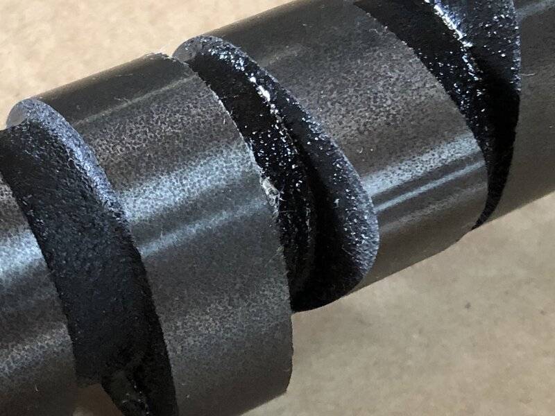

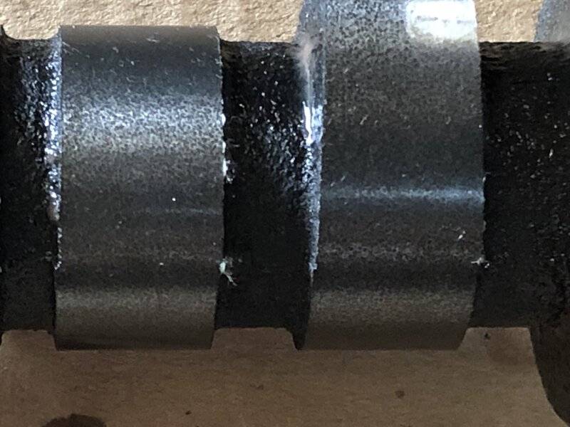

In 2020, bought a Comp Cams 280/480 for my 383 that had rough, unfinished edges of several lobes.
Being admittedly ignorant about the finer points of camshafts, I wasn't confident that I could just take a file and grind down the flash that was left on the edges of the lobes without risking a failed lobe later.

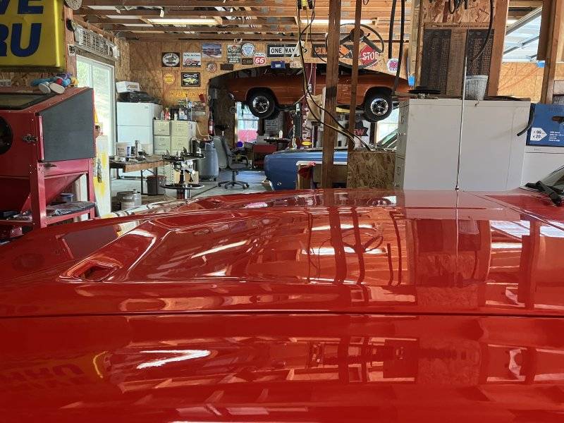

The Edelbrock Performer RPM barely clears the stock hood, even with a custom air cleaner base. No way in heck would a Victor intake clear.
I am not interested in squeezing out the absolute maximum power. The 68-70 Chargers were never fitted with an A-12 style hood where I could get away with a taller intake. I'm not cutting this hood or putting a scoop on it.

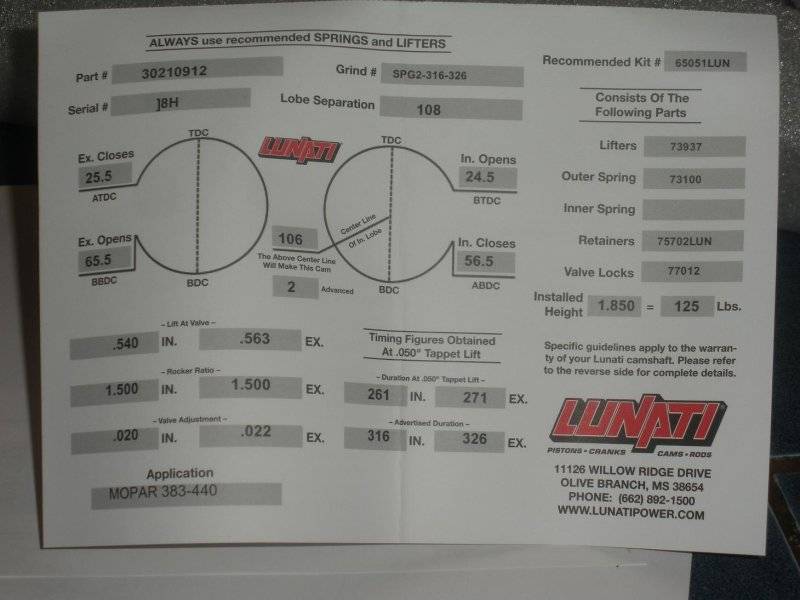

For a recap, this is the Lunati cam card. For the record, I do have 1.6 rocker arms but would switch to 1.5 if necessary.

With the 1.6 rockers, I'd be at 0.614 intake and 0.620.
Is there a published spec on the maximum lift I can have with the Edelbrock Performer RPM heads made in the early 2000s ?
The lift I have with the Lunati is 0.576 Intake, 0.600 exhaust with these 1.6 rockers.
