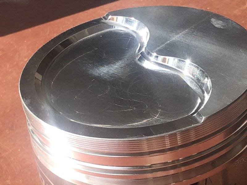

It varied a bit but started out with a deck clearance of .017 and a head gasket of .039 compressed. That is .056 right there. Later after 2 cams went flat, I pulled the engine, honed and re-ringed it, had the heads gone through and had a slightly smaller chamber size and .012 deck clearance. Then I was at .051 "quench".
It was not optimal. Cranky...YOU were one that advised against me using thicker head gaskets to lower compression based on the history of how mid 70s 400s and 440s had no quench and still detonated.
Somehow, the thicker head gaskets actually did stop the detonation for me but I knew it was a band-aid. The proper choice was to use dished pistons with quench pads like these:
These very pistons are in the engine now.

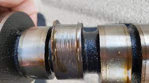

I've been pondering a roller setup for my next buildup as well. I've also learned they aren't infallible like popular wisdom says, and have seen a few wiped rollers up close. Some were factory parts, LS and gen3 hemi.
Here's the first few of the many pictures that came up on a gaggle image search of "lifter failure". Ouch!
