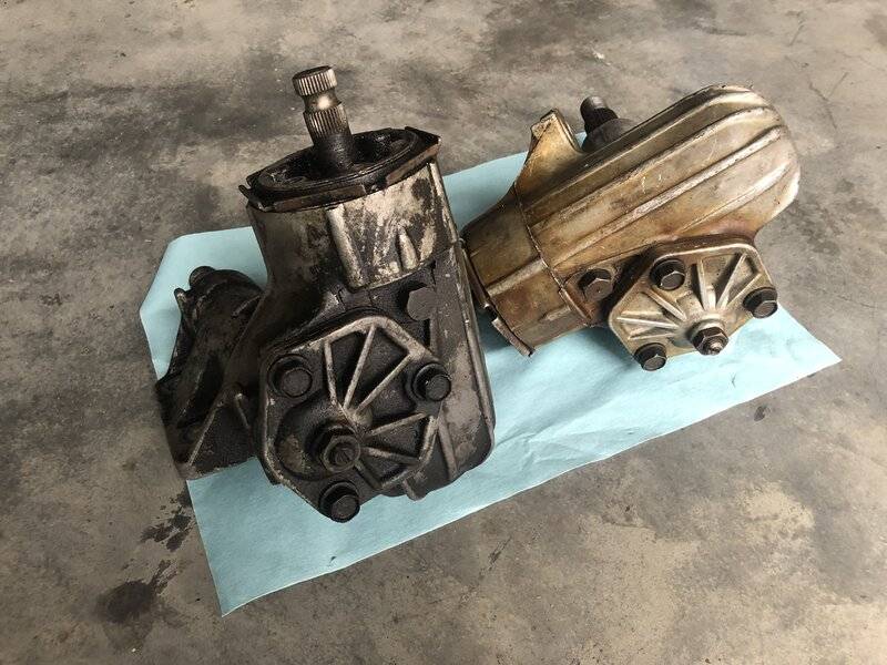

Still kind of on the fence about this but grabbed my manual boxes from storage to keep it in front of me. Didn't even realize I had two. The cleaner one is actually NOS, still has the Cosmoline on it! If I decide to use what I have on hand already, guess that'd be the one to use... although, the lubricant inside is probably dried up. Not sure I want to take it apart just to clean it and re-lube it, if I can even find manual gearbox lube.

NOS gear box, turn it upside down with the fill plug out and put it somewhere really warm in the Sun or on very low in an oven with a drain pan under it. That'll warm the light grease up and it'll drain out. Refill with John Deere "Corn Head" grease.
Thanks. No sun out today. Can use my heat gun on low, maybe that will do the trick.

Anyway, I checked the "NOS" box over. Definitely will need to be cleaned out and re-lubed, the old grease is all caked up inside. It turns but not smoothly. OTOH, the grimy one cleaned up OK and happens to turn much easier. Took that unit out of my Duster several years ago so I know it works however I'm a little skeptical about it. The adjuster is only showing about a thread and a half and it looks like the seals could be shot.
