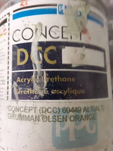

But for a complete job it's ok. Omni plus base is a good choice. MTK is a single stage urethane that is lower cost but coverage is ok. Then you can get into dcc ppg, covers good.

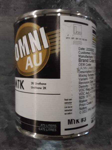

I've used Omni recently. I used the MTK single stage acrylic urethane. I had good results with it. It seems to be pretty durable. I did a hood and trunk lid with it. Durability I think is pretty good. Recently, I got a little dent in that trunk lid. Had a dent wizard guy work it out. Came out perfect and the Omni didn't crack. It lays nice. Kind of off topic; I used the Omni 2k primer and topcoated with the Omni single stage. Also, the Omni 2k primer is very good and sands well too. Not bad for a middle of the road paint. Probably others will say otherwise, but results were good for me.
