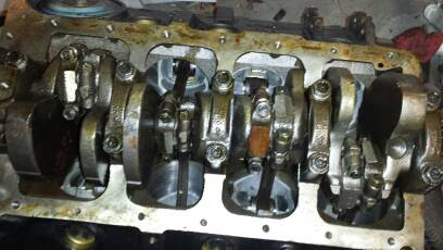

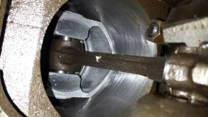

I know you guys probably don't think much of a 318, but I picked this up for 500 Bucks. Came with everything to get it running, plus a 2 brand new 1406 eddy carbs. It was some kid who didn't know what he had. Came with all the machine shop reciepts. Only thing was it sat for 4 months after the work.
Specs:
Bored .30
JE High Comp pistons with valve reliefs (gotta degree the cam before I can check the compression)
New Lunati Cam with lifters
Milled crank
New bearings
New freeze plugs
New Rods
Heads were just cleaned up Already bolted them on before I took pics. All fresh, hasn't been broken in.

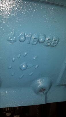

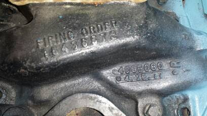

i just picked up an old 318.

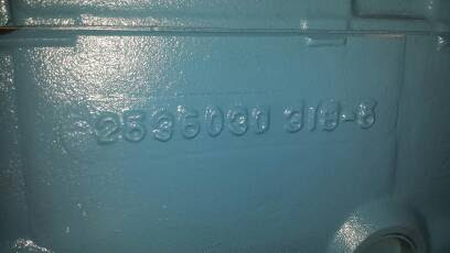

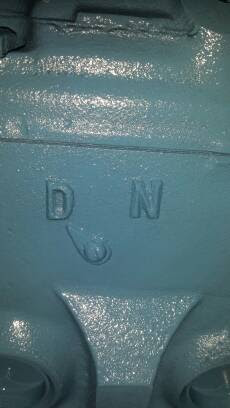

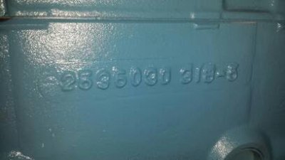

could you please explain the numbers and where they're located at?
Date code was 4/16/68 Driverside of the block.
2536030 318-5, I want to say that means La block? I'll have to look it up. Not sure off the top of my head. This is located on the passenger side.
