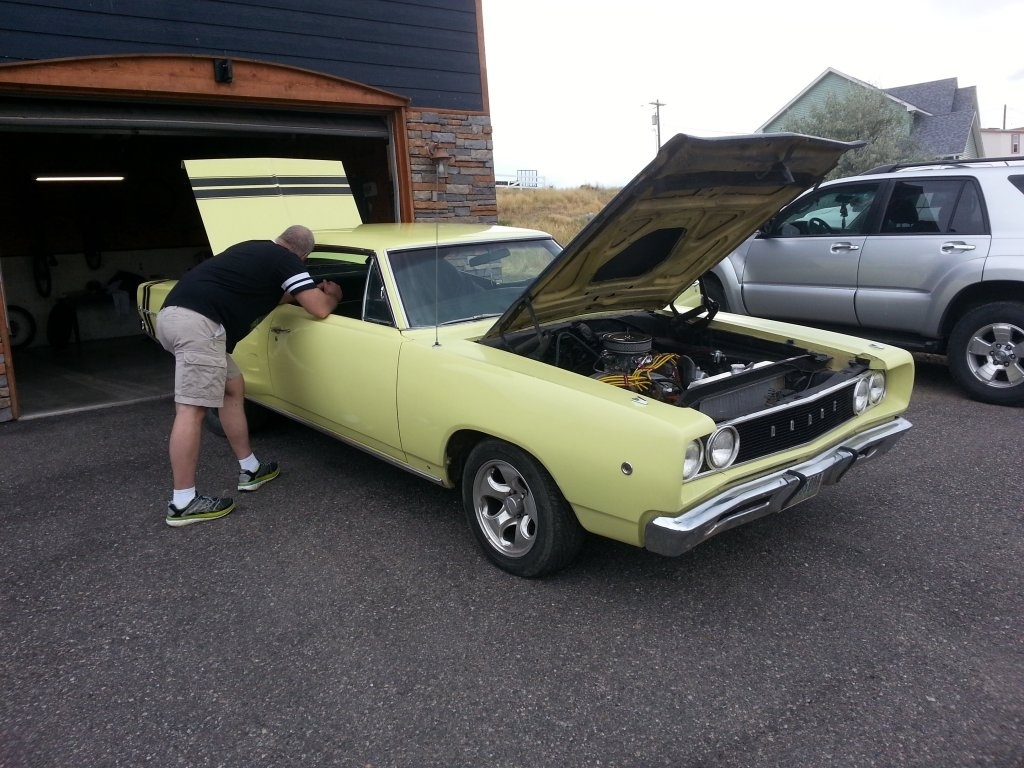

Looked at this car today.
Okay, here is what I found out about the Yellow 68 Coronet. VIN decodes original 318. Car had a vinyl top, and the body work looks well done. Rear backlite has been out and the repairs are very nice. Drivers side quarter is new. Passenger side door has two bubbles down low. Pulled the back seat out-no rust. Lifted the drivers side carpet-no rust. Underbody looks original, solid, and no accident damage I can find. The hood has some sort of bondo mounted scoop thats cracked everywhere, but the original hood is nice otherwise.
Headers don't fit and are beat up.
Has 'orange box' mopar electronic ignition spray painted black. Linkage from throttle to trans kickdown is a rigged up nightmare. New Demon 4 barrel carb and the car starts and runs great.
Someone put Volare/Aspen front disc brakes on the car-no power.
The electric fuel pump looks like it was installed by a drunk mechanic with one hand tied behind his back. Dash wiring has three miles of electrical tape everywhere and not much works. Heater core leaked and is disconnected. Front seats out of a old Dodge van and look awful. Exhaust falling off the car and no tailpipes.
As I mentioned previously, the seller converted to manual steering because he could not get the power steering box adjusted (always turned right).
Headliner looks pristine, all windows roll up and down.
Okay, this is the best $16,000 MOPAR I have found to date with a 440 727.
Can't get a firm price or WHEN I could ship it to Tucson. Please talk me out of this car.
