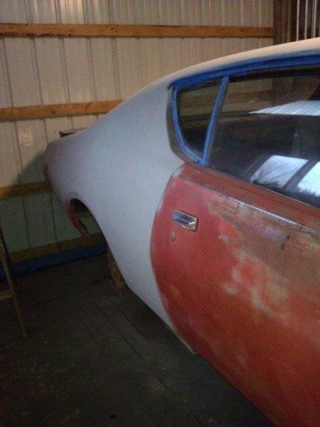

I did this last year...at this time, to my car. The results were terrific. When it finally got warm enough to paint up here, all I needed to do was wash and lightly sand the primer before spraying color.
WP_000878.jpg WP_001265.jpg View attachment 677529
