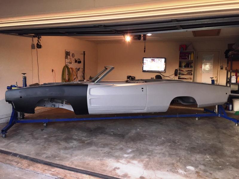

Greetings FBBO Family,
:hello2: 69Charger_Vert.jpg
This question has probably been asked a bunch (sorry) but I'd like to know the steps to take a body panel from rust to show room. I'm building a 69 Charger Convertible... Here's what I'm comfortable with thus far.
  1. Sandblast and wipe down
  2. Spray 2 coats of epoxy primer (where can I buy epoxy primer in Austin Texas?)
  3. Body work - hammer dolly, weld, etc.
  • Use Everglass over welds to get initial shaping
  • Use Everglass Ultra X for final shaping
  • Start with 60 grit - Final bondo sanding should be what grit sandpaper?
  • Epoxy primer finished work
  1. What comes next? Slick sand? 2X build?
  2. What are ya'll using to clean the panels with after sanding? Will acetone work?
  3. How are people fixing minor pitting in the metal?
Thank You!
Tim
