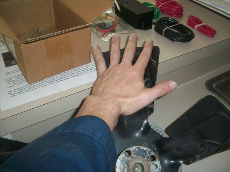

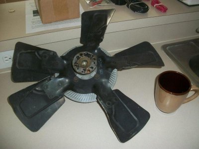

What the hell is this!!! Look at how small and puny these fan blades are! No wonder my car ran so hot! The fan blade is way smaller than my hand. Also, the clutch assembly makes it impossible to make the fan blades any longer, and there are huge gaps between the blades. I can see where there is room for up to four more blades. I don't know guys. It is looking pretty unlikely I will want to put this back into my car. I think I may have to go even more broke, and purchase a dual fan setup for the front, or at least a different mechanical fan. Then I will have four electric fans so even if one of them did die on me I will still have 3 fans. I am worried though about what fan to use as a puller because I have heard that there can be problems involved with running pusher and puller fans. I think I will call Zirgo on Monday and see what they have to say. Or maybe I just toss this fan back in and see how it hot it runs.

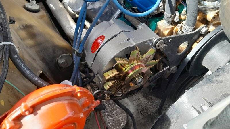

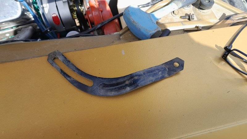

I was unhappy with the 110 amp square back alternators from proform. So now I am doing the 12si 140 amp. The only change I have need to make was the lower bracket. Found a more curvy ford unit and hammered it flat to work. I have a big dual cooling fan setup and an audio amp as well as 4 halogen head lights.
Ford Small Block Alternator Bracket D30E-10145-AA OEM​
Comparison, top is stock Dodge.
