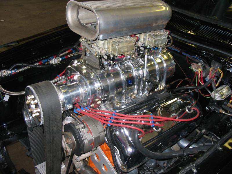

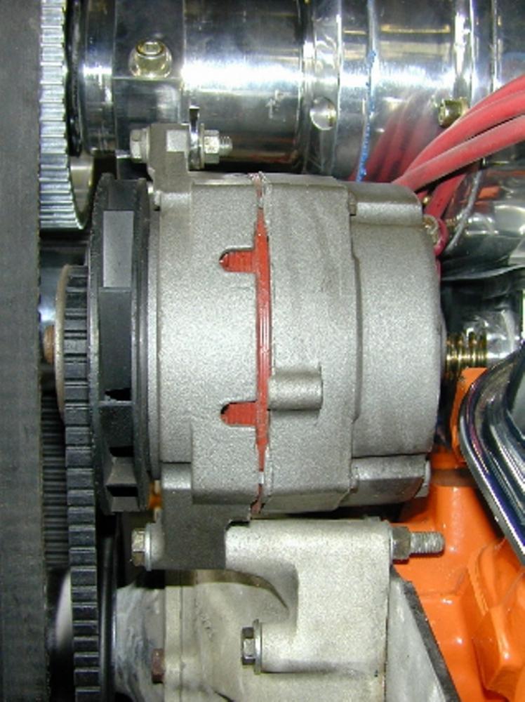

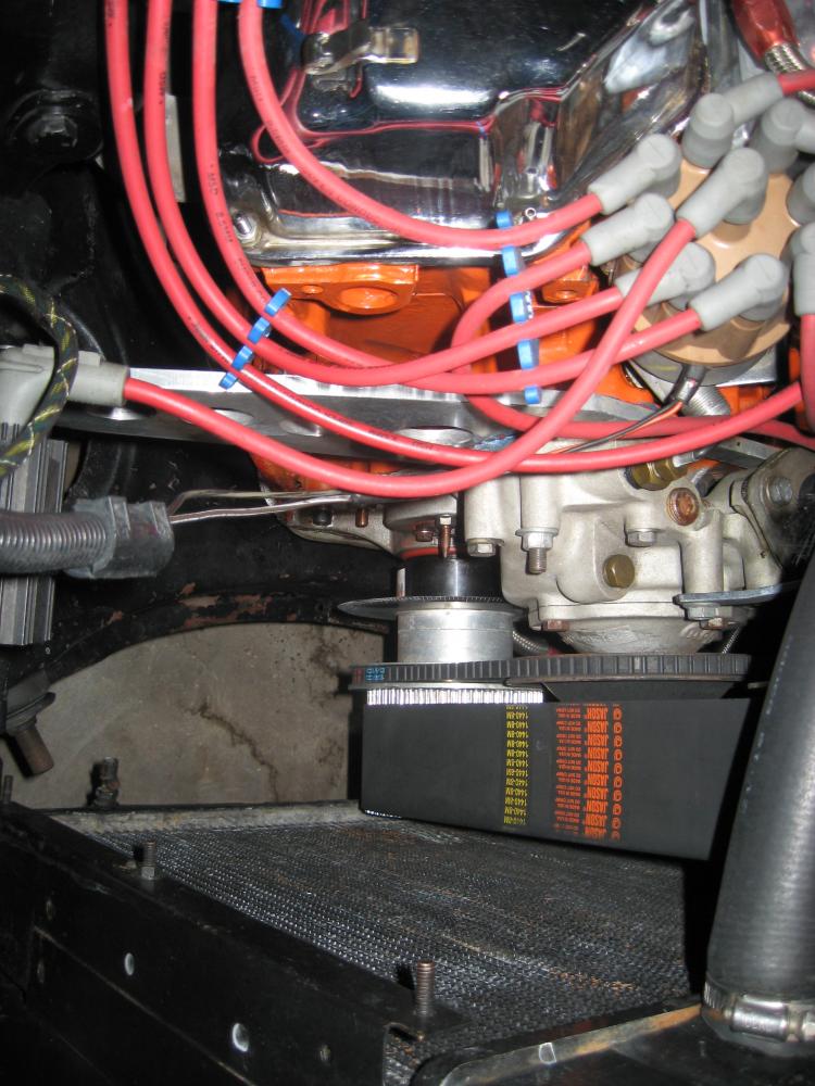

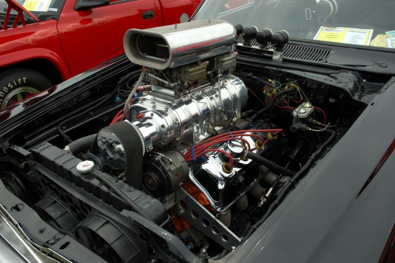

A few things i want to throw into the conversation.I use a one wire 100 amp GM large body alternator.I'm not up on the different part numbers available theses days.I never liked the stock location of the ma mopar alternators,seems like the belt was real long.When I installed this alternator,there were no MOPAR 1 wire jobs available yet so that gives you an idea how old this unit is.I also ended up mounting it on the power steering ear of the waterpump{big block} needing a pretty short belt.Just today I was at my shop figureing how to mount the alternator down low on the passenger side.The reason I had to move it,I shortened the blower snout to reduce the amount of spacer needed on the crank for pully alignment,,,,,,,,, and the alternator no longer fits where it was.Mock up was done and measurements were taken for 1 peice spacers instead of stacks of washers:icon_eyes:
The other thing,I run a dual electric fan setup from a late 90's camaro/firebird.Each fan is on it's own switch & relay.This way if one fan craps out,I can still limp home without having to get a ride to my flatbed to get home.I have NO ROOM for a puller fan :icon_compress:
That alternator you have there is a good unit. My problems with one wire alternator is the entire relay pack. Should that puppy crap out in the middle of Nowheretown, getting a replacement could be a problem. That and the output at idle is a compromise.
