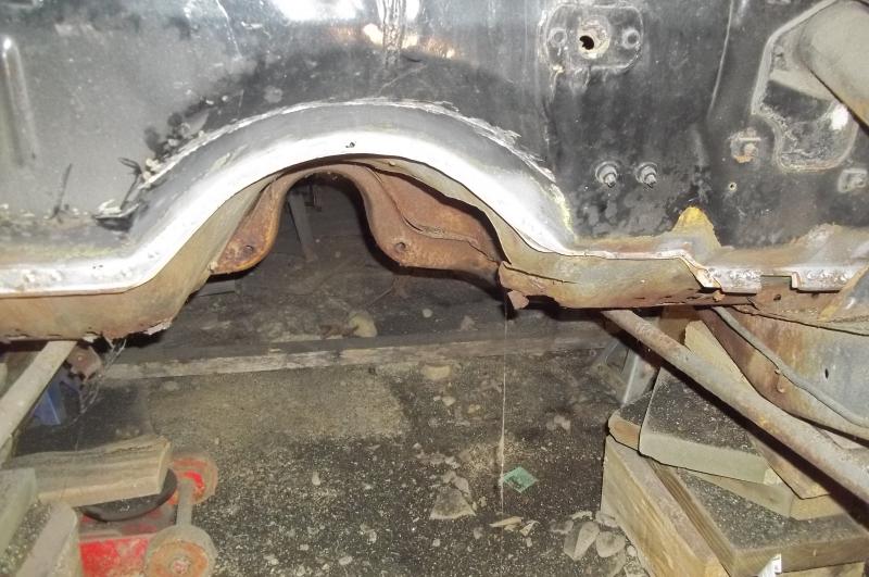

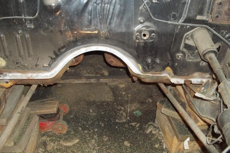

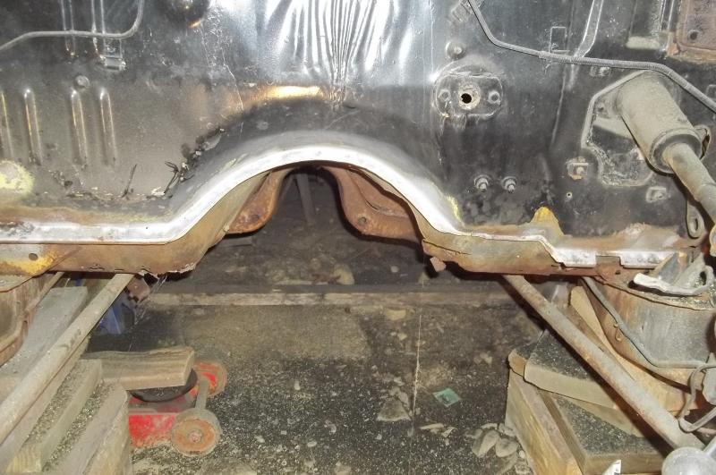

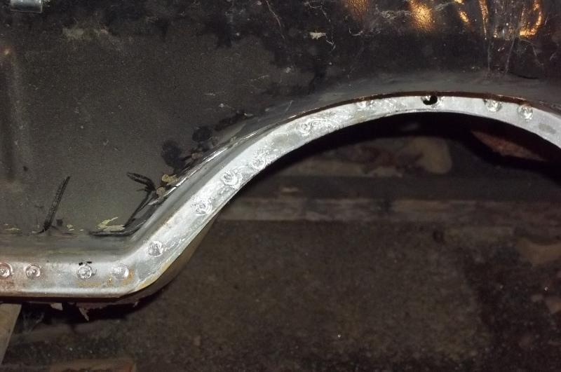

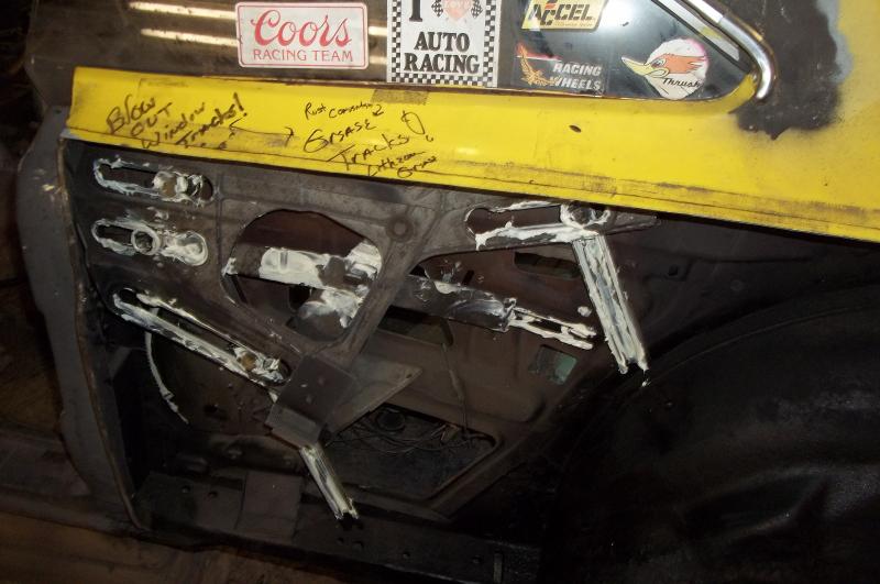

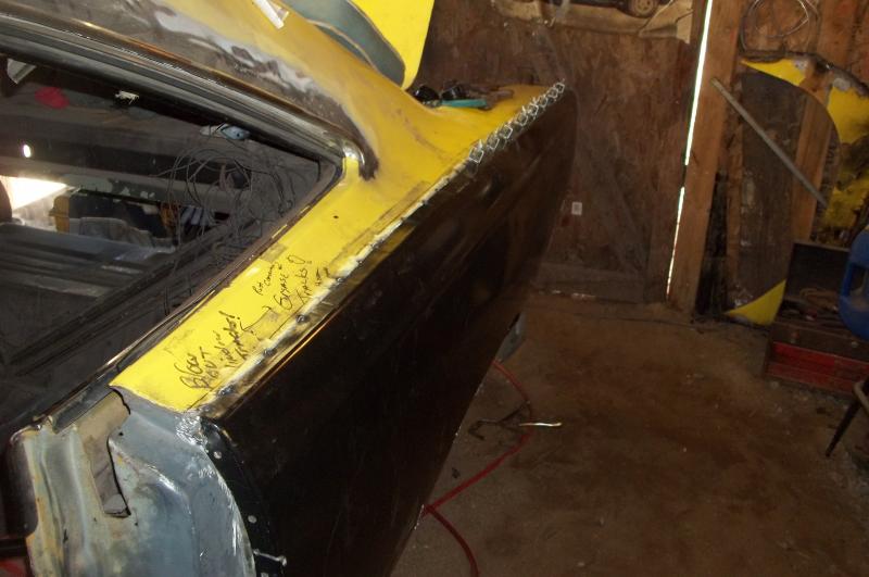

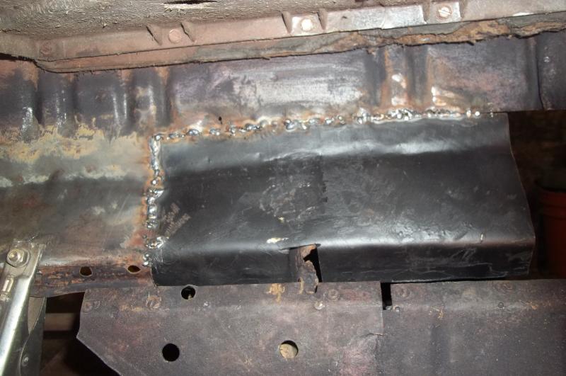

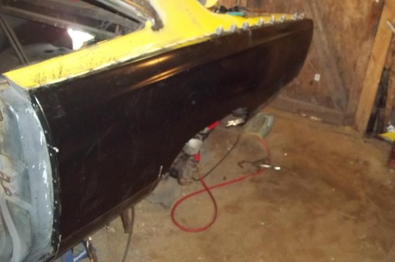

Guys, in-between waiting for parts or materials i sometimes find myself doing other work on the car and i came across a couple pictures that i cant seem to find in this thread so ill put them in, the holes (spot welds) drilled out on the bottom of firewall, the bad spot on the left is the one patch in the other pictures i started to repair, with all the new metal replacement parts i don't have a choice about, i am trying to keep as much of the original metal as i can, and i will do it as long as im not compromising the metal that it is not as strong and good as it can be, a lot of replacement parts i can get from Mark, not original to my bird but original 1969 metal for the crazies :)... i get as i imagine you all do once in awhile with people thinking im nuts to stuff money in a car like this and endure quotes like when i put all that Eastwood's encapsulater rust inhibitor inside the rockers and rails :HEY RON, why don't you just have it dipped in a big pool of that stuff!" lol, i love it and i say well, i made the remark that if this car ever rusts again someone can dig me up and explain it lol, hey, maybe i wont want bothered in 40 years after all this November im going to be 60, im not going to wake up to an old man (now young) and have any guff from him rofl... anyway, back to the program!

I got to tell ya Ron, your getting a heck of a lot done here. Those welds are looking pretty darn good too. You'll have that car all in primer in no time.

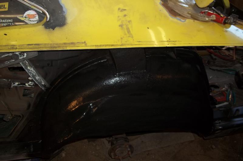

Fellas, i have been doing some grinding on the inner fender and quarter skin, i still need to do some more welding, lots of it, but im slowly making progress, ill get my camera and put some pictures of my work in here although it doesn't seem to be much to me.. I do thank all you guys for taking a interest in another old bird, ill be happy when its done i guess but i do really love doing them but i have more then enough time at this rate..

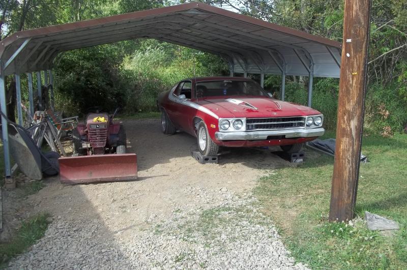

All is going as good as can be, some things are better then good! a day at a time and we will overcome, even a stubborn old bird wont beat us! Not this time anyway lol.. Sundays we do nothing, well i did run the battery down bad in the 73 listening to the radio and enjoying the evening, i took this one picture and have no idea why when i should have went in and took some of the work i have done, but ill leave it. ill have more of work done and planned work and i myself enjoy seeing pictures of other things you guys have going on in the resting hours while building your projects.., it was 90 degrees here today, hot is a great way to put it but sooner then we want, its going to get cold... hope you all have a good one! :)
Hey Ron, that looks like one beautiful evening pic. We have been really smoky here in Montana with all the forest fires to the West of us.

That's a very cool picture Ron. Thanks for sharing. It looks very peaceful and quiet.

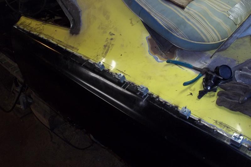

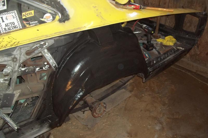

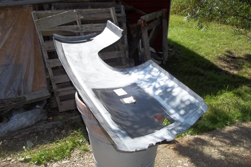

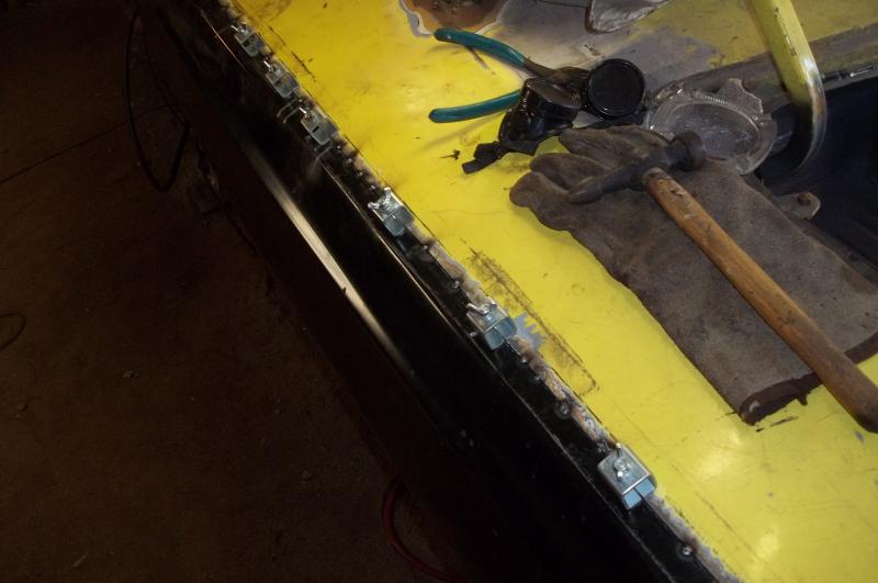

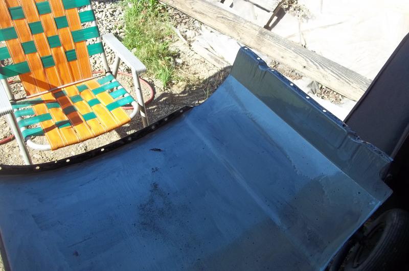

Before i down load these (i do hope) the radiator i bought from EBAY, i would need to try to find the paper on it to tell ya the price of it but i am very happy with it in my 73! some POR-15 on the inside of skins after roughing the metal up with some sand paper so it sticks well (Thanks Joel "elk" ) rust inhibitor under window mechanisms and skin on and bottom and top spot welded in place, one final check of everything and then a LOT of weldin! one patch while i was waiting on some things went onto the firewall on P-side, not done yet but its started... I will leave a picture of Gabby girls new Lab pup, he doesn't look perky as normal but i was in a hurry, also our garden (cant wait for canning don't ya know :) ) but we use and love tomatoes, peppers will be cut and froze and winter squash will last us the winter, a small portion of wood im getting ready for to, lots to keep busy but when winter comes, as long as the stove is filled, im happy in my small shop, getting larger though:) and taking care of Gab's when she gets home, life is good guys...i hope to be back soon... and it will be great with the 73 inside this winter again, no money now so a huge tarp will go over this 18-21, next year ill tackle enclosing it right... I greased the front end today, hopefully tomorrow ill be washing and if all gos right the second waxing of the year, ill put it back under the roof until we go somewhere with the car cover on to keep the dust off, dirt roads is a pain with keeping cars clean but we love the country side of living...
View attachment 270913View attachment 270914View attachment 270915View attachment 270916View attachment 270917View attachment 270918View attachment 270919View attachment 270920
View attachment 270922View attachment 270923View attachment 270924View attachment 270925View attachment 270926View attachment 270927View attachment 270928View attachment 270929
