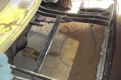

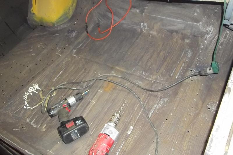

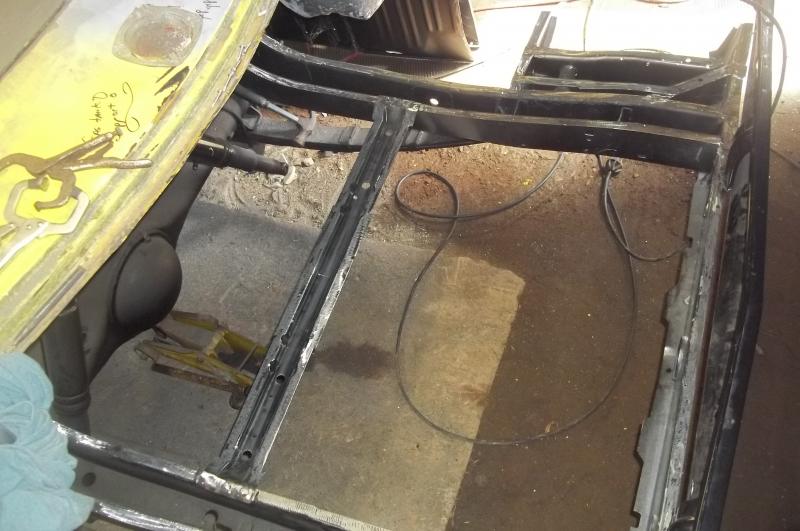

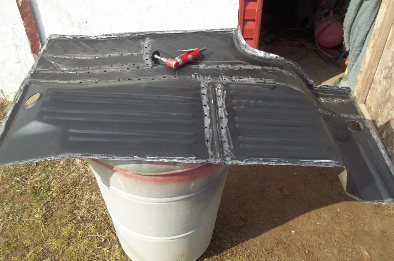

Im sorry im slow and things are busy here but ill put in some pictures, Im sure you all can understand them, Im using Eastwood compound in place of sealers and i think i like it better and more important, i think it is better, Metal to metal and i didn't realize how this was possible until i took or i should say had some outside and it was cool to see it in the sun, Kind of looks like Gabby girls glue and glitter lol... I can see where it can be stronger....

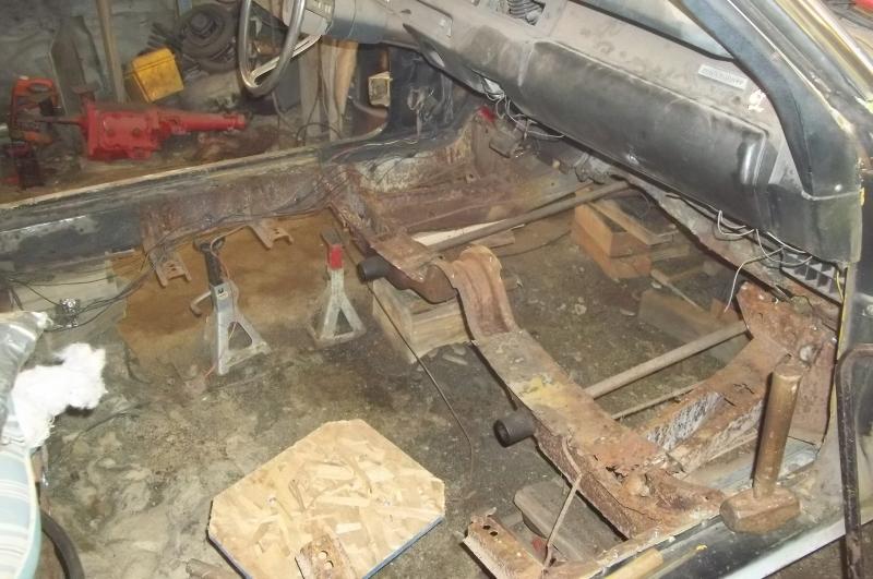

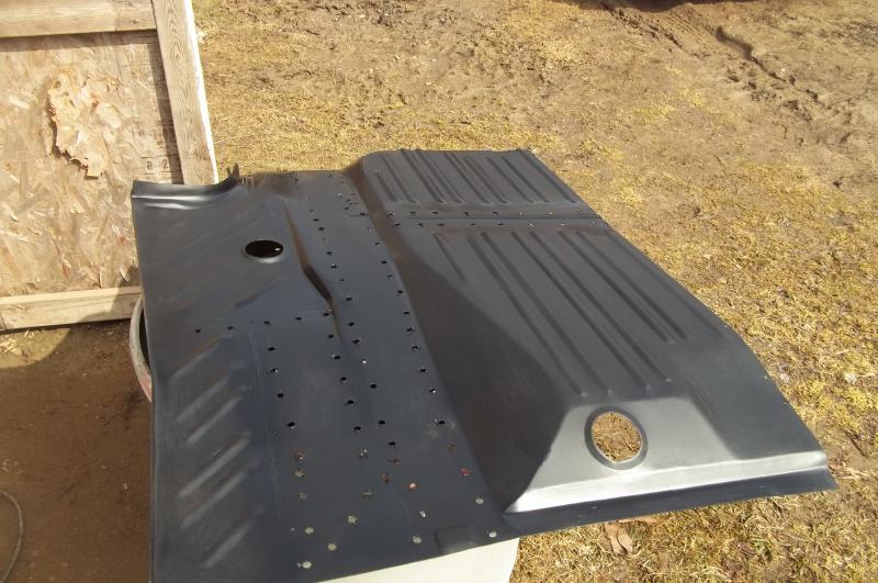

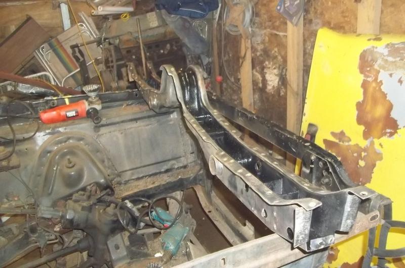

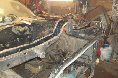

I have the torsion bar cross-member and the 4 floor brackets i bought from our Mark (moparmark), I have them cleaned up and coated, ready! Main floor is out and new here, back foot well's are hear but ive been doing the trunk pans and moving on from there with the back, i still haven't taken out the torsion bar's themselves but im sure that will come soon.. MAN, I wish i was a lot healthier and a LOT younger, NOW that would be cool as it gets!!! :)

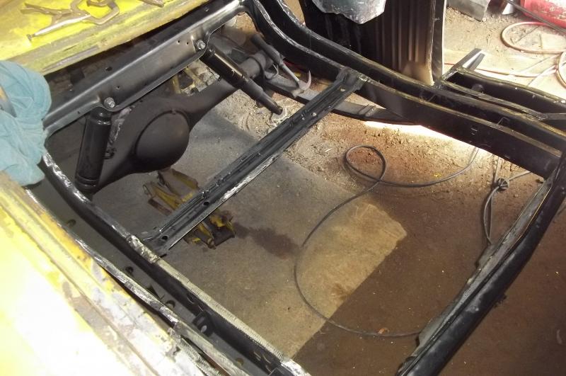

I thought i had more of the trunk pan work but i think i was thinking of the ones on my phone and not the camera, but my welds aren't the prettiest anyway and i know i have a few more out in my shop on the camera, showing the penetration from underneath that ill try to get soon, Im also working on my 73 and trying to do things around here and not keeping up i guess..

Wow, nice work there Ron! Rails and trunk floor look great.
Heck ya. You are definitely doing some fine work. That cross member really cleaned up nice and the rails look great. I have lost ambition for my car right now, but I think it is because spring has sprung and I'm busy in the yard. That's OK though because I can still watch others and get my fix!
Lookin' good Ron, yours looks like my Coronet did a year ago. Keep plugging away my friend and remember you're only as old as the amount of pain medication you have to take at the end of the day. :tard:
Ron, Ron, Ron
The cross member DOES NOT get attached to the tops of the inner fenders! :grin:
Seriously, some really nice work, and you are making good and steady progress. You are turning the corner and starting to put stuff back on the car - that's a great feeling! Keep up the good work!
