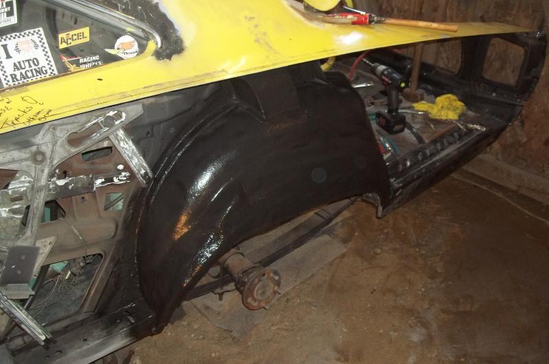

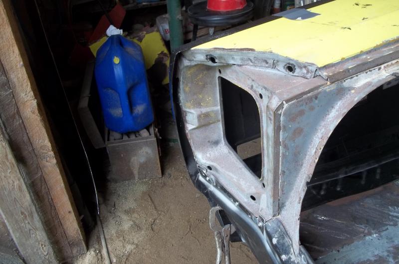

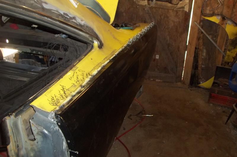

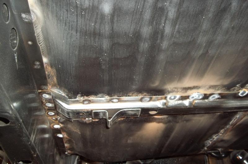

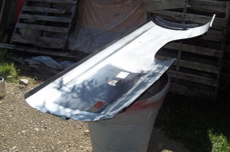

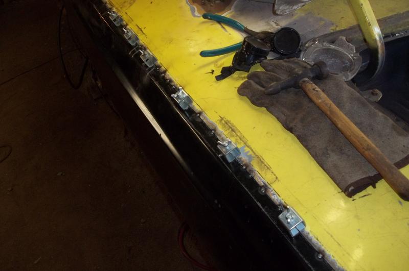

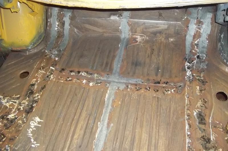

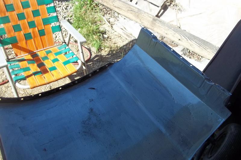

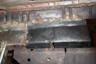

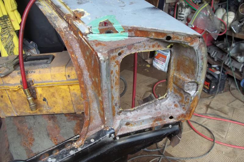

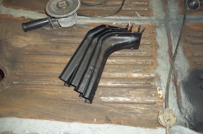

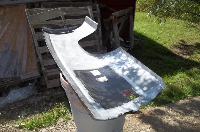

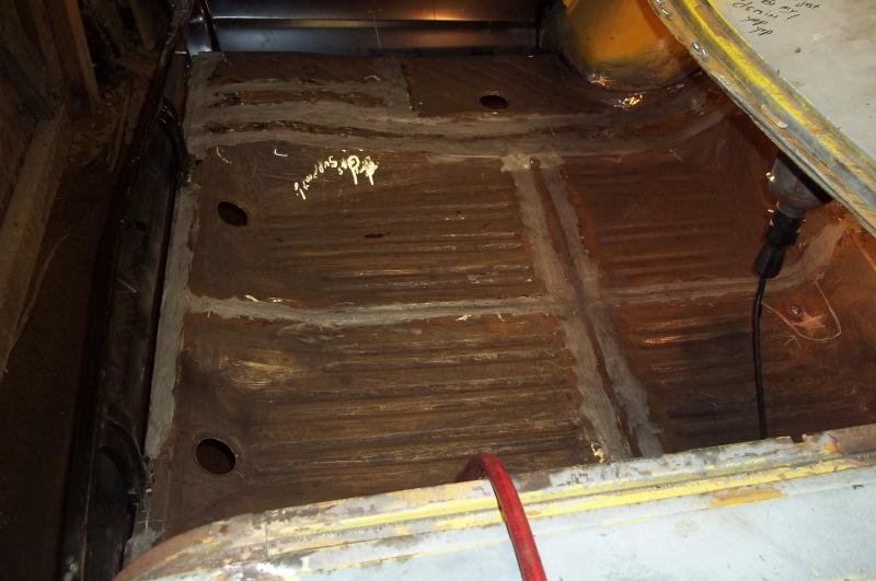

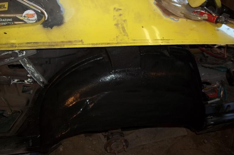

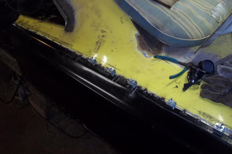

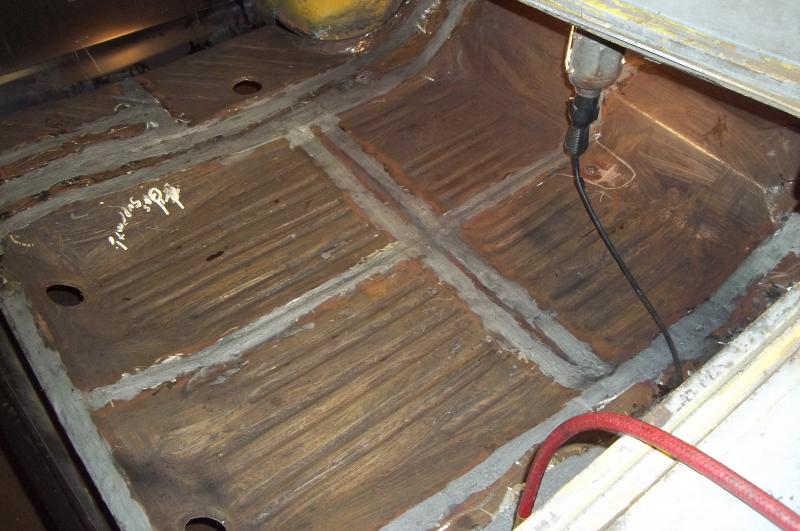

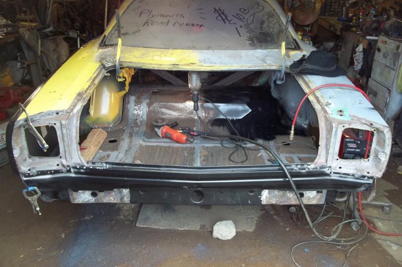

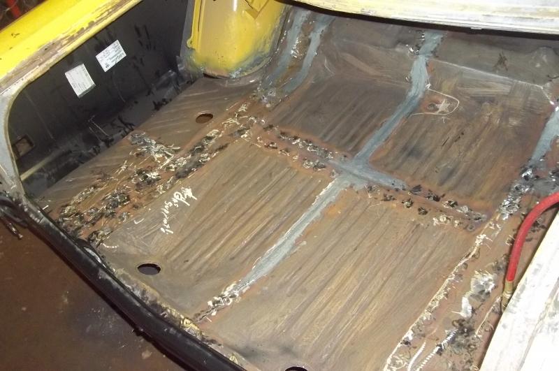

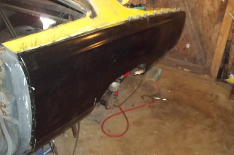

I thought i ordered my Q-skins thru AMD.. WRONG... Another company and they fit good everywhere they should except in the back, they made them so they go over the tail light buckets so i cut it off and made tabs to bend in where original was.. (see pictures)... I also found some pictures im not sure i put in so ill leave these, trunk pan welds and seams sealed.. ill try to remember my camera in the AM and get you pictures of the skin on and started. Im sorry im late and forgetting, so much happening here im absent minded worse then normal! After the skins are on the inside will have a good coat of primer, tommro i should have another update with inner fender and skin on and started... The floor braces at end i bought from Mark (moparmarks), just as better if not better then new, the 3 core radiator sits in my 73, very good investment. Later guys...

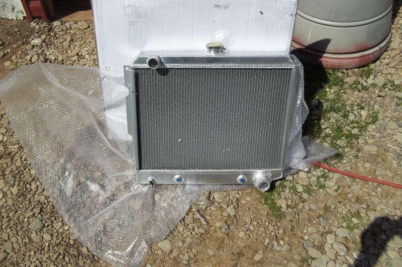

You have to love new sheet metal! Progress,moving forward,and looking good...where did you get the rad? It looks nice.

I like the new radiator too. Where did you get it?? I'll be looking for one that will fit my Challenger.

Great work Ron. May I ask what alum radiator that is?

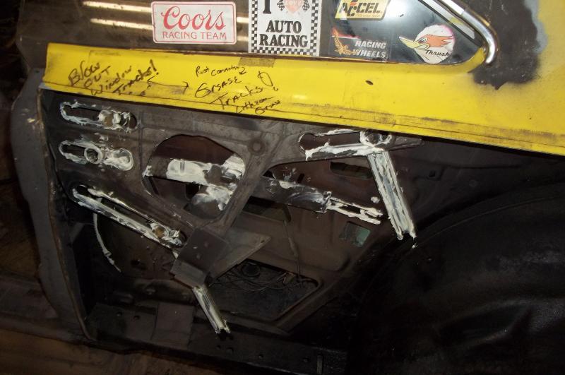

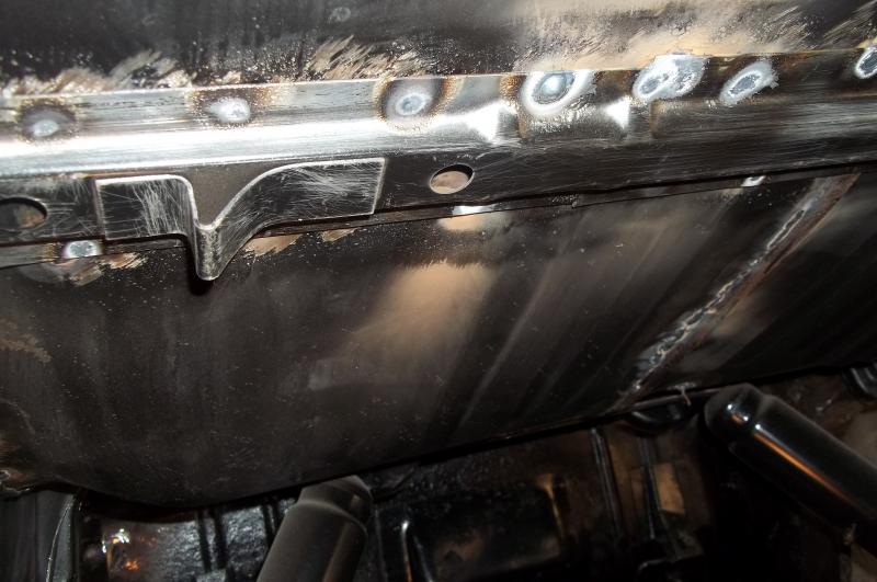

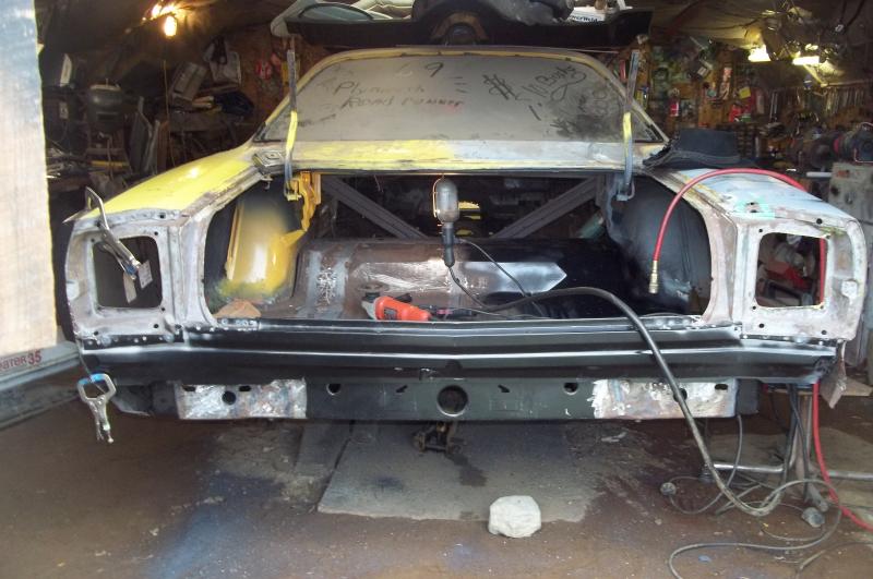

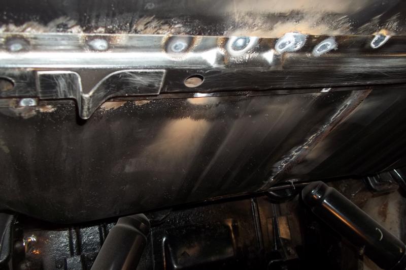

Before i down load these (i do hope) the radiator i bought from EBAY, i would need to try to find the paper on it to tell ya the price of it but i am very happy with it in my 73! some POR-15 on the inside of skins after roughing the metal up with some sand paper so it sticks well (Thanks Joel "elk" ) rust inhibitor under window mechanisms and skin on and bottom and top spot welded in place, one final check of everything and then a LOT of weldin! one patch while i was waiting on some things went onto the firewall on P-side, not done yet but its started... I will leave a picture of Gabby girls new Lab pup, he doesn't look perky as normal but i was in a hurry, also our garden (cant wait for canning don't ya know :) ) but we use and love tomatoes, peppers will be cut and froze and winter squash will last us the winter, a small portion of wood im getting ready for to, lots to keep busy but when winter comes, as long as the stove is filled, im happy in my small shop, getting larger though:) and taking care of Gab's when she gets home, life is good guys...i hope to be back soon... and it will be great with the 73 inside this winter again, no money now so a huge tarp will go over this 18-21, next year ill tackle enclosing it right... I greased the front end today, hopefully tomorrow ill be washing and if all gos right the second waxing of the year, ill put it back under the roof until we go somewhere with the car cover on to keep the dust off, dirt roads is a pain with keeping cars clean but we love the country side of living...
Ron on the quarter tail light area make sure the tail light housing and trunk all line up nice before final weld. On my quarters this area needed the most work.
