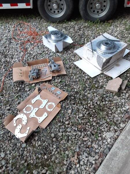

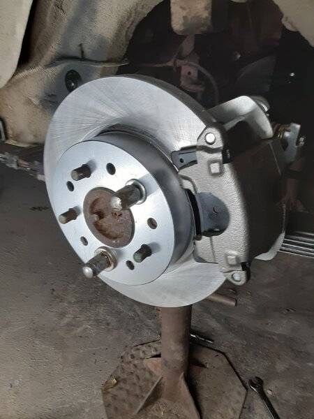

I dropped off the rear axles today to have the green bearings pressed on them. The guy who does them won't be able to do them until Monday. Today I am going to break open the Right Stuff rear wheel disc brake kit and see what is involved with getting the kit installed on the car.

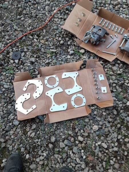

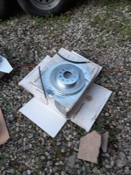

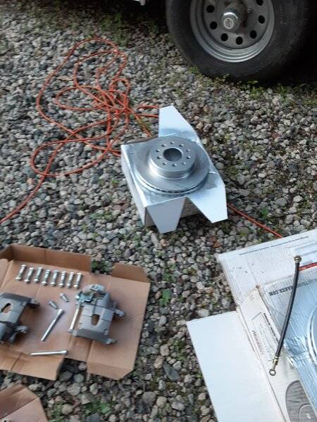

Some people would think that I was suffering from OCD,but I cleaned and clear coated all the parts in the new Right Stuff rear wheel disc brake kit. My reasoning for doing this is that it really bothers me to put brand new parts on my car,and have them end up looking like they came on the car back in 1970 a month after being installed on the car. I used high heat clear on the parts,then I used 1200 degree heat heat silver paint on the rotors front, back and in the cooling fins,then I cleaned the paint off the contact areas for the pads. I just think that it keeps the new parts looking new a lot longer. I am not going to drive the car in the winter or on wet days, but sometimes you can get caught in the rain when you have the car out,and some protection on the bare metal parts cannot hurt. The Right Stuff kit looks like a good quality rear brake conversion kit.

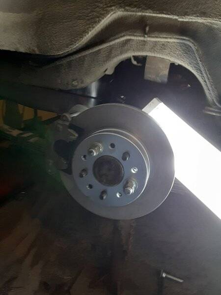

My wife picked up the axles with the bearings pressed on today. I had to work late last night so I couldn't pick them up yesterday. Depending on what time I get out of work today, I might get to install them in the car.
My wife picked up the axles today,and they look great! He charged me $80 to press the old ones off,and install the new ones. I just finished push mowing out in the heat for a few hours at work,and it's about 90 degrees in the garage so they are not getting installed tonight!

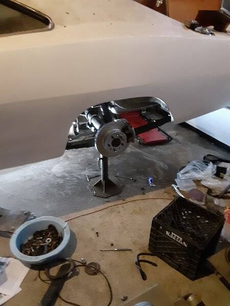

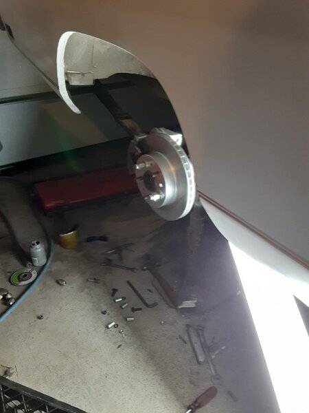

Tonight I got the axles installed,and the rear wheel disc brake kit installed,making some progress!
