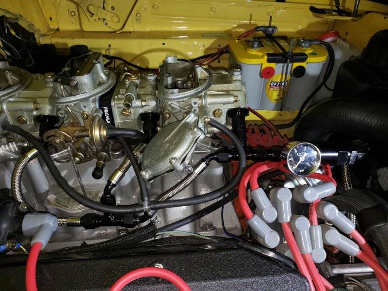

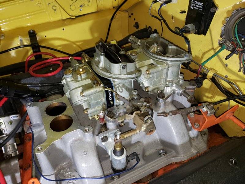

I got the majority of Promax 6 bbl upgrades available, and likely the couple I missed will be added when I send them my 3 x 2bbls.
My 70 V-code (71 motor) 6 bbl overall runs good. Nice kick in the *** when the outboard carbs open gradually under vacuum, which I can feel the smooth but powerful transition when I am half throttle or so and let the RPMs climb, increasing vacuum and transitioning the outboard carbs open vs up shifting w/my standard transmission. Same thing when I stomp it from a dead stop. No stumble or hesitation. I occasionally have some idle weirdness, and the carbs over weeks seem to always creep richer.
Anyway, the point is that after I spent some time tweaking them soon after I got my Roadrunner about 4+ years ago, they have run pretty well.
I am bonkers for the 6 bbl setup, I'm stoked to take them to the next level, and when I top off my future stroker motor with the 6bbl the Promax parts will be invaluable.
I'm getting a dual band wideband O2 sensor and gauge soon as well, and I will finally install the new Carter M6903 high flow fuel pump I've had for 2 years.
Install complete. Those damn silver aluminum fuel fitting to fuel bowl washers sucked for me, 2 out of 3 leaked badly. I replaced them with the factory thin steel washers and that fixed the leaks. Promax is sending me nylon washers, so I may try them, but I may not anytime soon since the leaks are gone.
I still have to adjust the 6 idle mixture screws, but I took a test drive and it was pretty good, just still rich at idle.

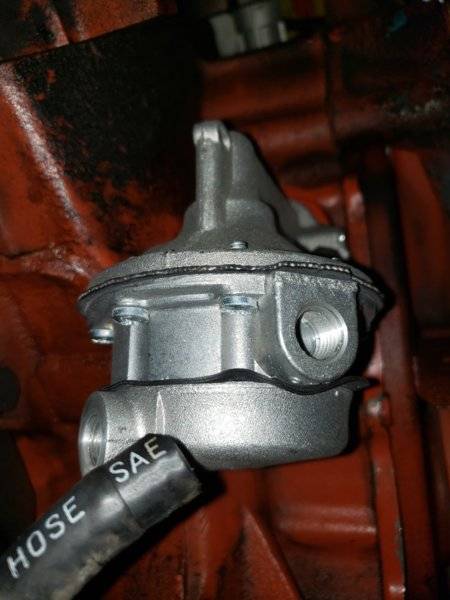

Also installed the Carter M6903 mech fuel pump which I really like so far.

After the date of the video I had a whole week of drive time w/the new Promax modded Holley carbs. Something is wrong because other when I first got my car and the outboard carbs were not opening (required a slight adjustment of the threaded rods that connect to the throttle plates) other than then, my car has never run worse.
:BangHead::cursin:
I have a bad stutter that I have had a week to evaluate and seethe over.
My thoughts are some debris got through to the carb(s) so I am going to disassemble and clean.
I'll follow up (unlike Promax)
EDIT:
To be fair to Promax, I just got off the phone with them. They were out of town at an event.
He made some suggestions, I will follow up with a post.
:BangHead::cursin:
EDIT:
