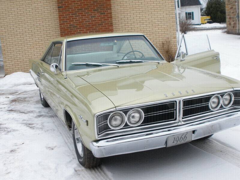

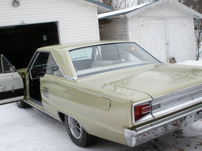

If it really is all original, that is a good price for a Coronet 500 big block with that few miles perhaps the one of the lowest in existence.
Note that the wheels are not original, but that's a minor thing in my opinion.
Originals are included

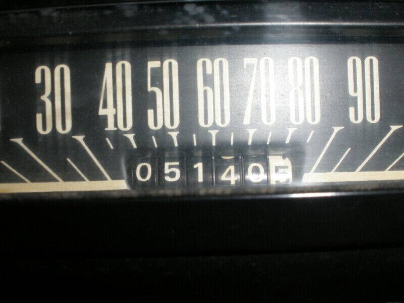

66 bb coronet. Under 10000 mile car. Indoors most of its time.
