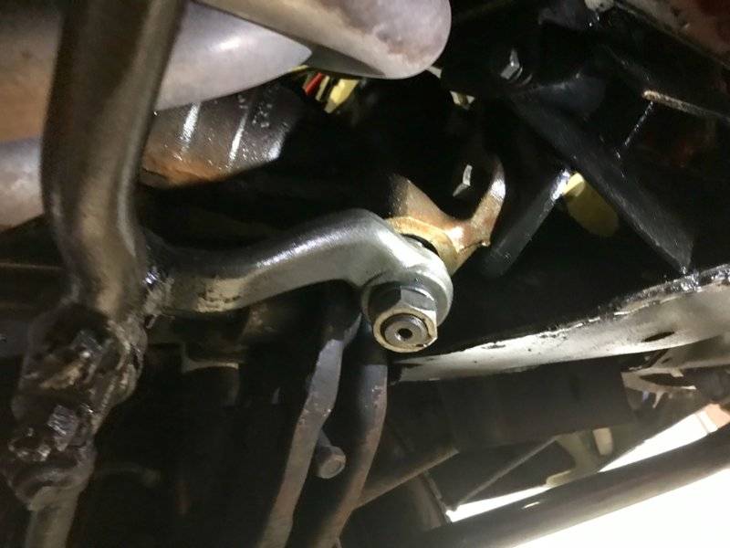

Factory manual steering with Chrysler power steering set up added. Firm Feel Stage 1 put in later. Wet everywhere. Been in for about 20 years and lots of miles. Wiped it clean and put dye in it to narrow leak. Maybe an opportunity to go to Stage 2. Lousy picture. Drives perfect and is quiet. Only symptom is the fluid leak.

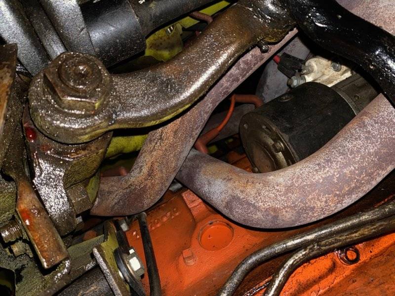

This photo below shows the soaked pitman steering arm. The bread pan, under the front of the gearbox, almost totally fills up only after starting and running the engine till warm once! My K-Frame also gets covered with the stuff. It is a mess!

View attachment 893271 Factory manual steering with Chrysler power steering set up added. Firm Feel Stage 1 put in later. Wet everywhere. Been in for about 20 years and lots of miles. Wiped it clean and put dye in it to narrow leak. Maybe an opportunity to go to Stage 2. Lousy picture. Drives perfect and is quiet. Only symptom is the fluid leak.
