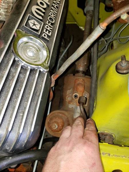

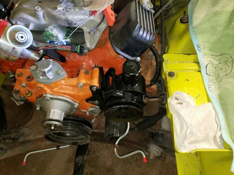

Installing pump on 70 Coronet. It looks like a TRW pump. Fits nicely to H20 pump housing, return line fits nicely but pressure hose has different fittings than steering box.
I looked in my collection of fittings and found something that went into steering box but nothing that adapted. Whats the best cure, have a new hose made?

I think the brass fitting you have is close, but you need a smaller end.
Steer and Gear would have the correct fitting.
Make sure to flush out the line before connecting it. The centering valve in the box is pretty finicky to foreign matter.

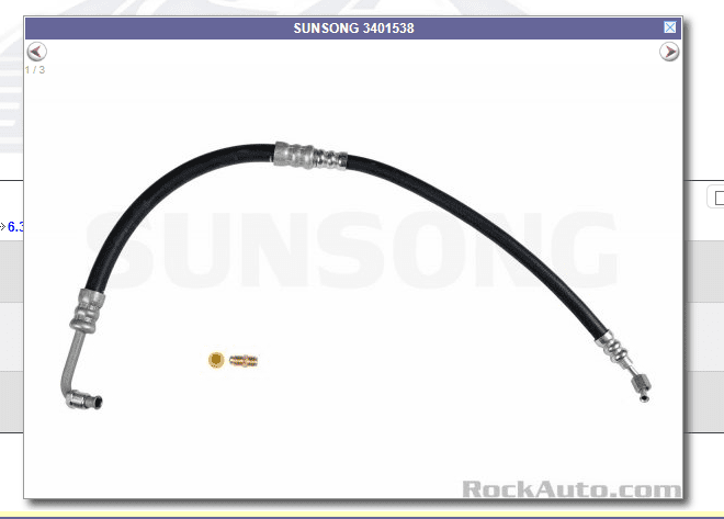

I think this one will fit, RockAuto Listed under 66 Charger:
That PS pump looks just like the pump thats in my 66. I can check that hose and shoot you a picture but its dark out there now.

Im guessing the problem is that my car is a 70 500 that came originally w a small block ps and the pump and hose Im retrofitting are from a 66-67 BB setup. Ma Mopar must have changed the pressure lines ever so slightly in between.

I'll agree with post 13 - it's hard to make out in the pic, but it looks like the box fitting is missing. It would be flare x pipe thread I believe. Your pic looks like a 1/4 flare x 1/4 flare, not correct.
The pipe thread end goes into the box then?
Yes, but it’s not really pipe thread; just looks like it. See if there’s any Parker-Hannifan stores around, in addition to the above ideas.
Thats what I thought
