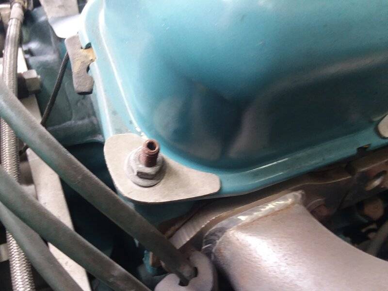

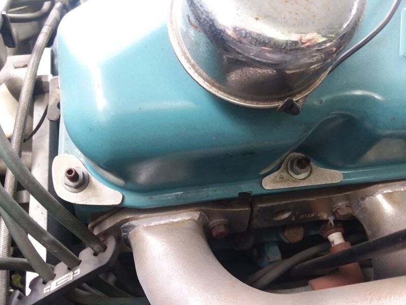

What I did was get some 1/4x20 set screws, and locktited them in the head. They are automatically grade eight, available in any good hardware store, and lots of lengths available. Then, instead of washers, I just use homemade load spreaders and hardware store nuts.
The set screws length can be adjusted for whatever covers you want to use.
Edit: these are the paper thin moroso gold covers, with a coat of Mopar turquoise. The spreaders are almost mandatory!
