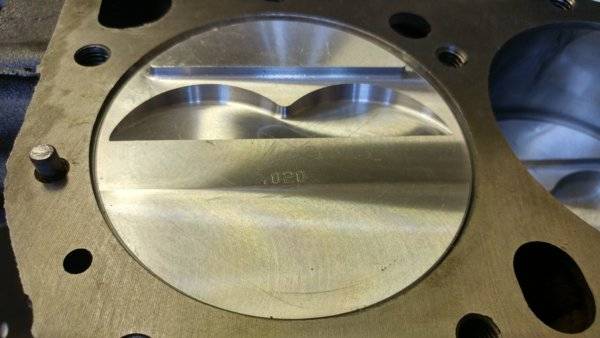

The quench dome pistons are a neat idea, but a lot of work to setup properly.
My 360 engine used the KB-232 pistons that only had a small 0.050" quench dome.
With those pistons, the connecting rod pin ends needed to be narrowed to 1" to start with.
Then I equalized the head chamber depths, and had the block machined so the pistons were near zero deck height (I think 0.001 or 0.002" below?), then had the heads milled so the quench area was about 0.050" from the head surface to match the step dome.
Then I mocked up the engine without the head gasket (using 0.040" head gasket to set quench distance), the quench dome was just slightly lifting the head off the block. The reason was the step dome is straight, and not contoured to clear the raised "eye brow" area around the valves on the stock iron heads. So the quench dome needed some slight contouring to match up the the head chamber correctly. I would be careful if you decide to mill the heads, as it could be more work if the step dome does not match the chamber correctly like in my case. Really, I just put it together, it looks like a nice combination.
As for the factory heads, I had at least 20+ hours of labor in porting, equalizing the quench distances and head volumes, cutting the spring seats and guides for the performance valve springs and seals, opening up the pushrod holes for 3/8" pushrods (small block), and opening up the tall center head bolt hole for oiling when using head studs. And that was on top of the cost of new valves, guides, hardened exhaust seats, valve job, and milling both the block and intake sides of the heads. I believe the compression ratio did come out to about 9.5:1 which is what I wanted. I used the Hughes SEH1620AL cam with Crane 1.6:1 rocker arms (0.528"/0.536" lift), and the engine runs better than I though with what I considered a small cam. This was built to be a torque/RV type engine in my RamCharger, and it worked really good, but I rolled the truck. I'm thinking of taking the 360 and swaping it for the stock 318 in a Coronet 500 I originally bought as a parts car, but is too nice to tear up just for parts.

Thanks again, I have pretty much came to the conclusion to go together as it is with the .020 gaskets. At most take .010 more off the heads to get the quench in the .040 to .050 range and maybe help compression a small about.. That would only be a total of .020 off the heads. My next move is to clay the other bank to very its a match to the fist one. I also want to check my lifter preload as it currently is with the original pushrods. I do really appreciate all of this
