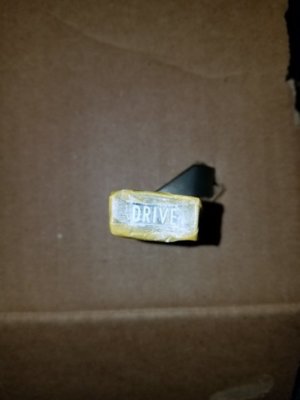

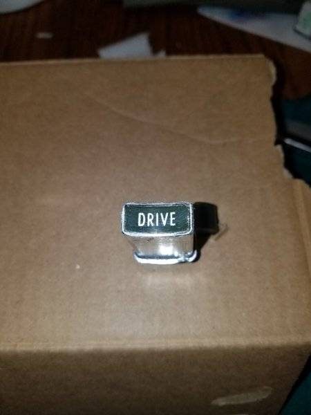

Thought I'd give yaz an update on the button resto FYI. The photos show my mule drive button in painting process and then after cleaning and buffing. I used water-based paint from a hobby store 'flooding" the indents gently wiping off excess for later polishing after it dried. I used rubbing alcohol with just slightly dampened paper towel to remove the residue. The prep involved using sand grit sticks I found at hobby store when buying the paint to get the old paint off then went with a wet sanding process with 2200 grit before the painting. Well, aside from the raggy condition of the button I'm not too unhappy with the results. The idea was a vivid return of the lettering...now to keep my often greasy fingers off them before 'pushing em huh. Also I tried another mule button using a crayon painting stick and less happy turn out.

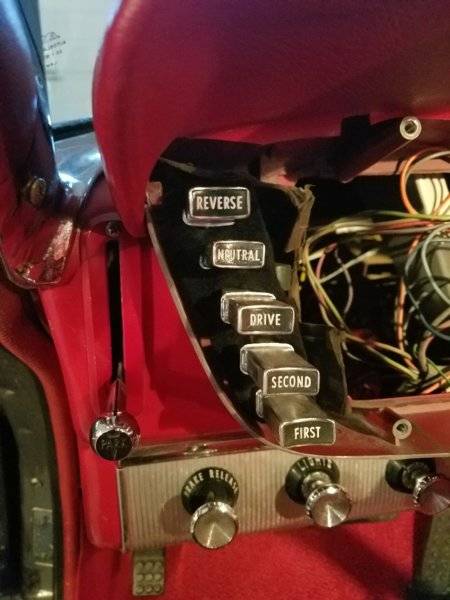

For those interested in this project here's the latest. DON'T use any alcohol based **** on the buttons. I used water-based paint and it was evident that's what was initially used as water would start breaking down the old paint. Except my nifty idea even gently using a bit alcohol to remove the overlay was a bad one. It etched the plastic. I'm now testing some other stuff to use to remove the paint...including just water.
I'd just use your dremel, on low speed with a small, (no bigger than 1/2" dia) wool buffing wheel. Try the white rubbing compound. Most water base acrylic paint won't be affected by water once cured. You'll have to test a sample and see what it does. After buffing you can wash off the compound embedded in the letters. Remove the aluminium sleeve so it doesn't get messed up.
