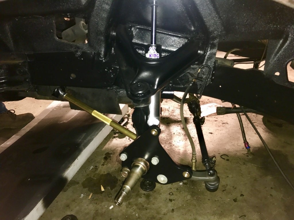

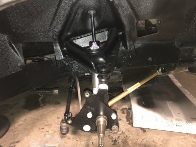

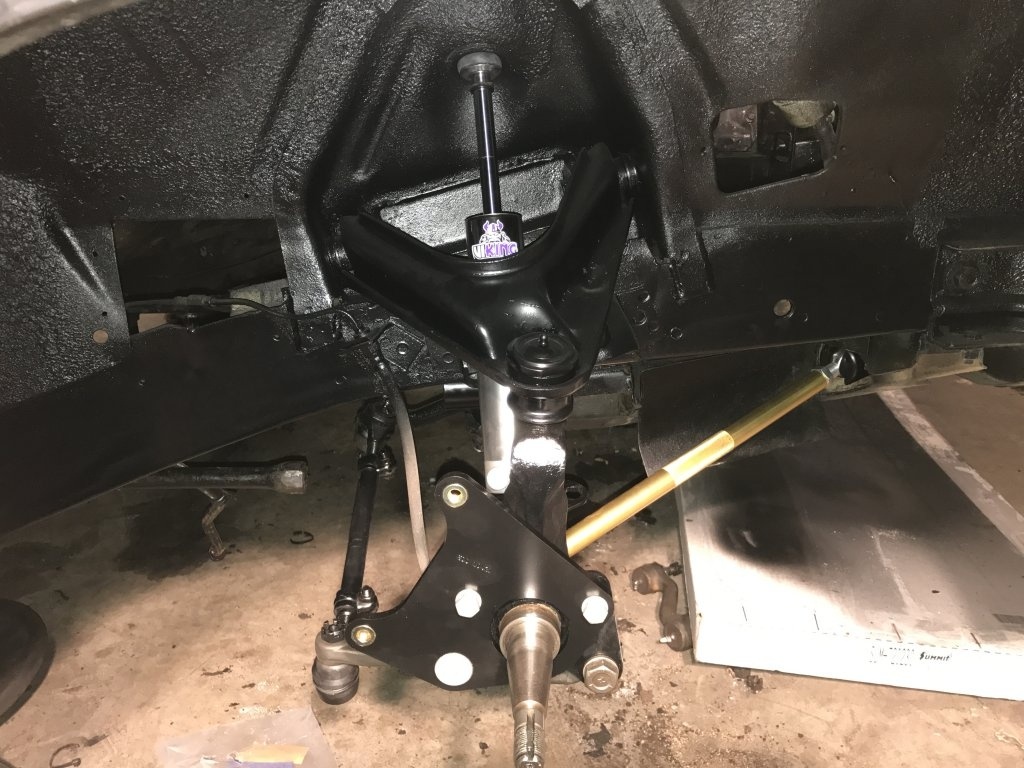

UPDATE:
Got things about buttoned up, pulled the trigger on a set of dynamic strut rods also, boy are they nice. Everything fit perfect, still have to make some adjustments. Got the wilwood caliper brackets mounted also

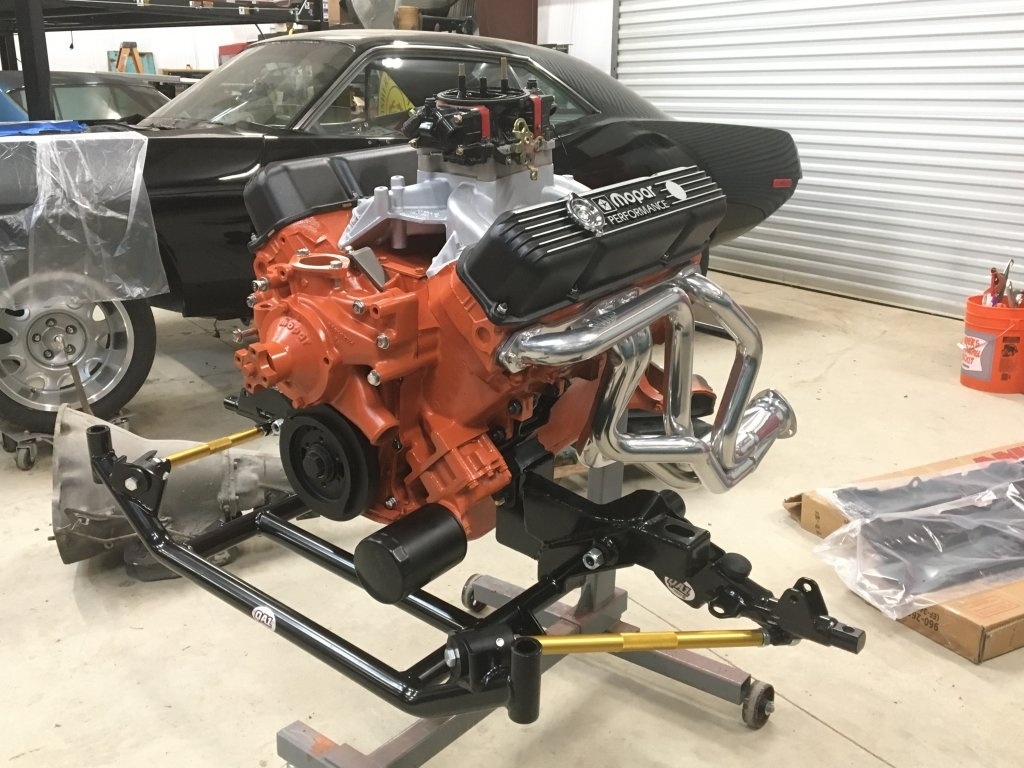

I know this is an old thread but wanting to get a little more info from those of you that purchased the QA1 LCA. Mine were purchase over 2 years ago for my 69 Coronet and I am just starting the assembly now. The car was totally dissembled 2 1/2 years ago and that process and the parts I removed escape my memory. In fitting these up, I have slack on the nut side of the shaft, toward front of car. I didn't receive any type of bushing with the QA1 kit to take up that slack and wondering if I need to go back to QA1 for a bushing to fit their product or a Mopar vendor to get a new bushing and which one is it? In the Classic Industries catalog, there are two listed for the LCA. One is short and one appears to be longer but no explanation of where each is used and why are two listed? In looking at the service manual, I see a bushing listed but unclear as to its actual shape or if it is needed with the QA1 set up. The QA1 fit up is metal shaft to metal sleeve sliding through the K frame, it would seem there is some type of bushing needed. Any help or explanation would be appreciated gents.

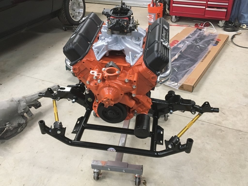

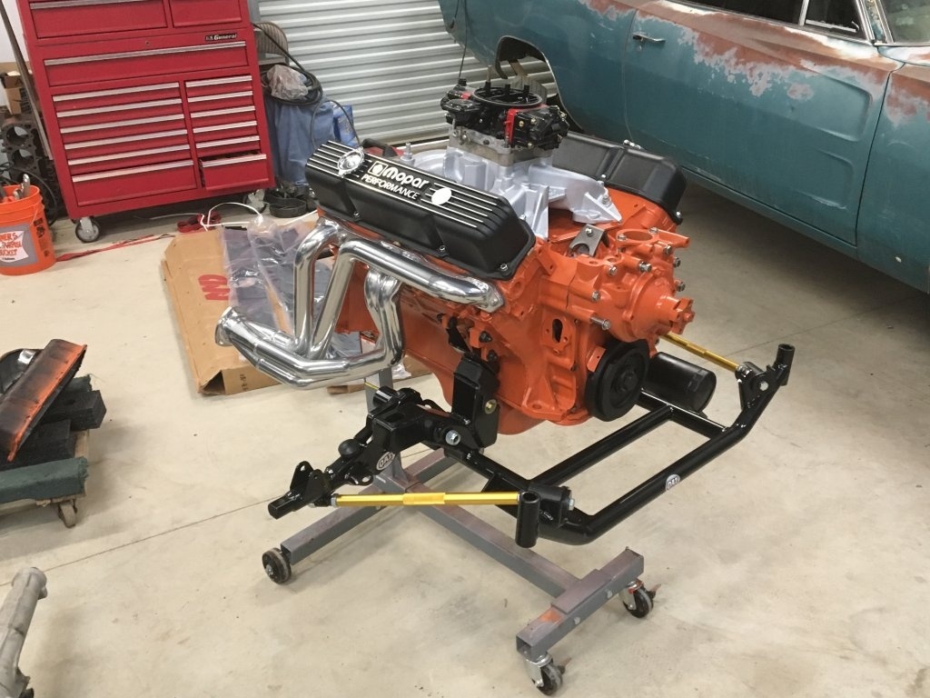

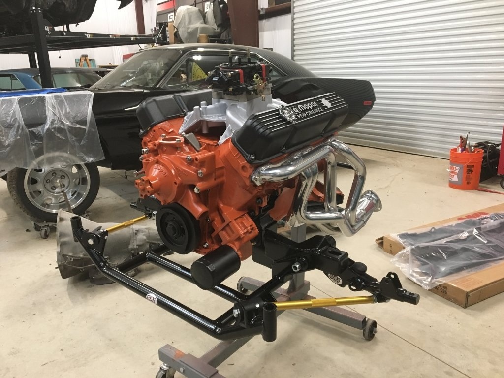

Seeing the picture of their k-frame reminded me of a question I had for one of the QA1 people, Mopar guy too, at the SEMA show years ago when they introduced it. The question was, what happens when you put a floor jack under it like you would do a stock k-frame. Answer after thinking about it was make sure you bridge both tubes. He was cautious about that reply too.
Let me know if you need any pictures. My lca just came with a washer and a lock bolt. I also have the qa1 k member. Only issue I’m having is that the lca is either set too low or too high with the torsion bar. So either I get no shock travel or can’t get the lower control arm to bolt onto to the spindle
