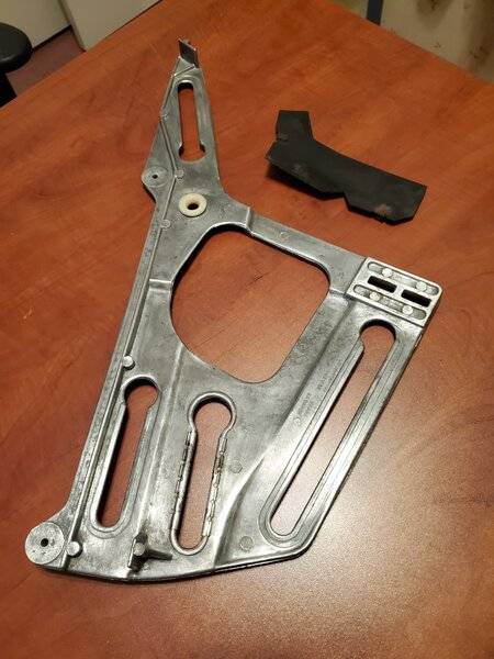

Hello to everyone,
I am cleaning up the rear window mechanism:luvplace: and was wondering what others do when installing the rails, slides and pot metal frame for the quarter glass. Should you just apply some oil to the frame and grease the rails for the guides? It seems painting wouldn't be a good idea. Also where does the small black plastic piece go? :rolleyes: Thanks everyone.

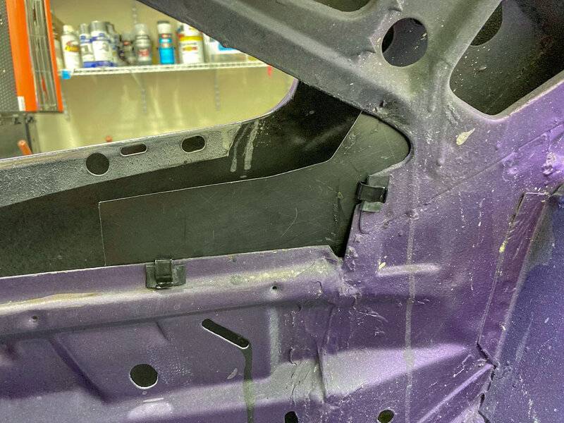

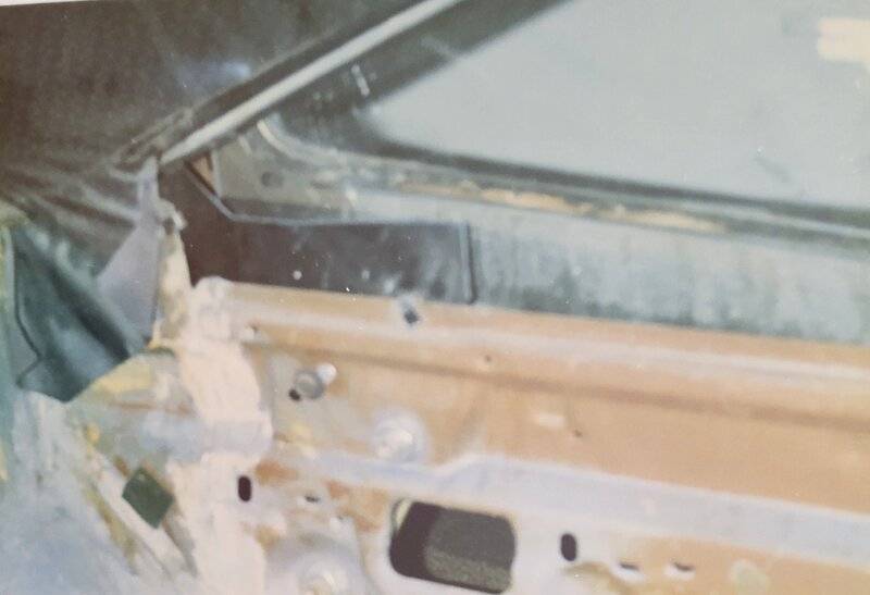

When I restored mine, I remembered greasing them. With what? I can't recall. As for the plastic piece, see the pic. Although this is a Superbird, that piece goes in the same location on other models.

I added a thin rubber shim under the clips because they didn't fit super snug and didn't want them to rattle. Pretty sure this is a water shield and looks like an afterthought.

I was wondering what the shield was called because I need to order one for the other side.
