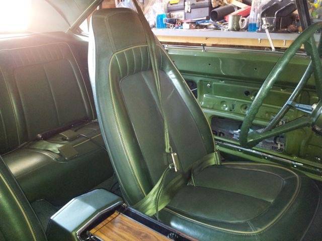

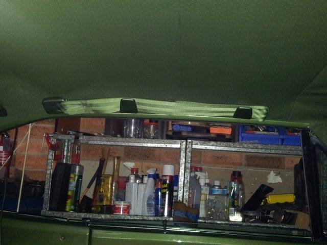

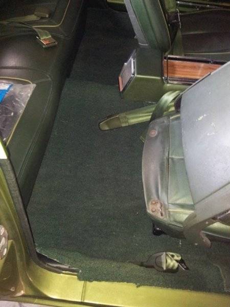

hi guys. first let me say this is the greatest group of guys on the planet. so much help here. my question is how are the set belts laid out in my 70RR? i bought this car disassembled and i am having a hard time figuring out the seat belt arrangement. whats up with the buckle clip on the ceiling? is there a shoulder strap that hangs up there? does the free standing piece go next to the console or on the edge by the door? if anybody has any photos with the seat belts buckled together with nobody in the seat, that would be great. any help is appreciated. thanks
Hi Dave. I've got some here from my '70 GTX. The shoulder belt hooked up in storage. The lap and shoulder buckles where they mount by the console, and where the stalk mounts. Also the three hooked up together. Hope this helps.
Cheers, Glenn
