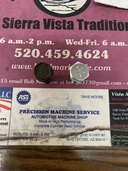

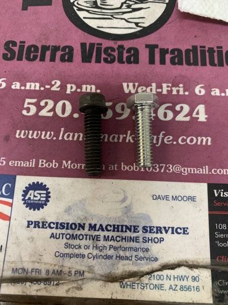

Both bolts are 5/16"x18, but the heads are a different size. Left is 7/16" and right is 1/2".
Ah, now I see thanks.
Now...what size socket am I going to need to take with me then?
5/16, 3/8, 7/16, 1/2. A little extra weight in your pocket, but saves you a trip.
