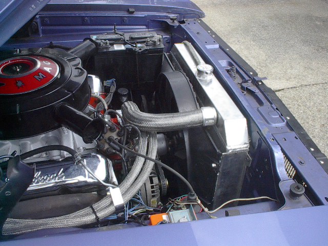

I just installed a 3 row champion alum with 6 blade steel clutch fan and shroud. (in 67 coronet) fan is too far into shroud but still cools the 440 at 160 down the road and no more than 190 in heavy traffic. Went the electric fan route and didn't care for it.

I paid 219 for the champion,direct fit...connected a 70 b body shroud to the already in place holes....money back guarantee for almost any reason and is about My 5th rad from champion through the years as I keep switching cars...lol

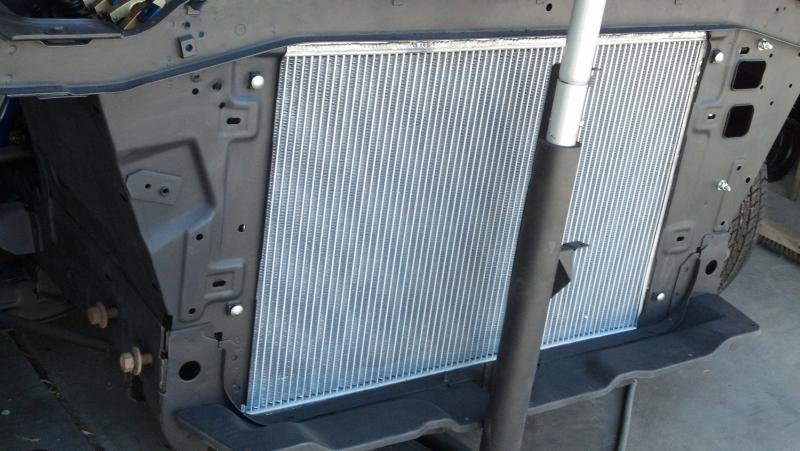

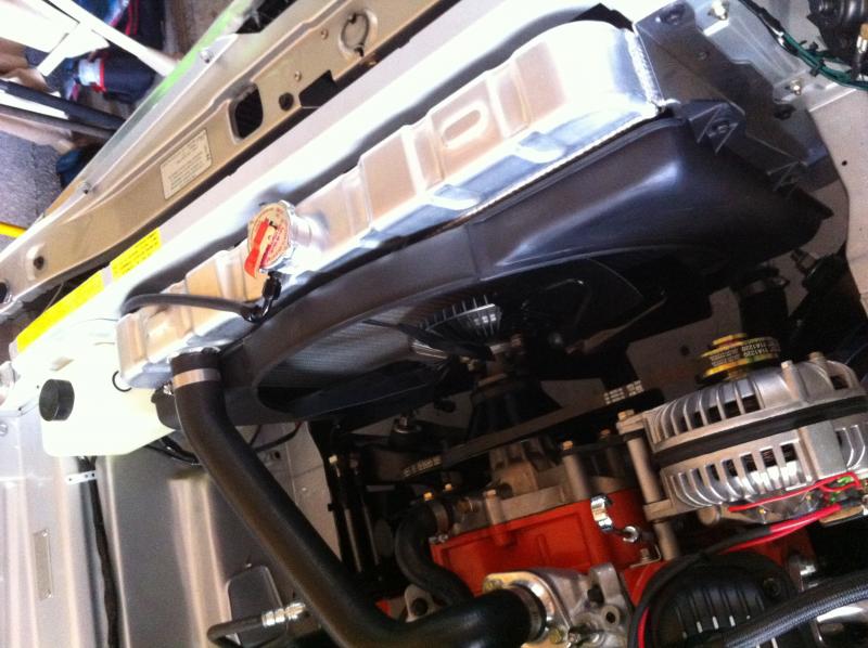

Just installed a US radiator aluminum. They are direct fit and have the original looking stamp tanks. Beautiful radiator by the way. Seven blade fan with a heavy duty clutch and factory shroud. The 409 stroker will run at 160 all day. I need to put a 180 thermstat to keep it warm.
i am running same radiator as jasoncoronet.383 with 180 stat factory shroud.replaced the fan clutch a few weeks ago and can't believe how much cooler it runs.staying at 180 running in 95 degree heat

Heres a pic of my radiator. US radiator very happy with it
