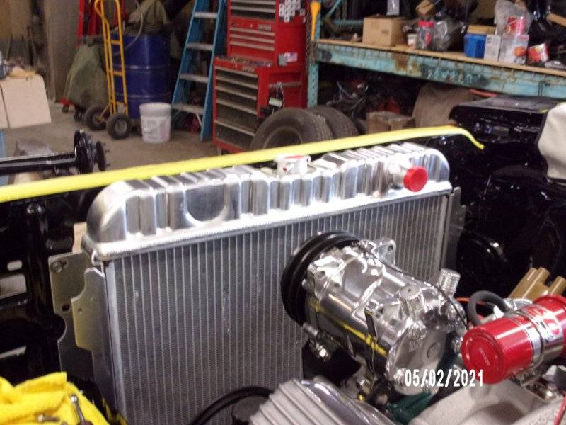

Yeah. I ordered the same rad from these guys just now. Looks exact Except it’s the one for the 318 poly, auto trans. Did lots of reasoning and math, it’ll fit good and I’ll not get rolled by the high dollar rip offs out there.
My 62 radiator came from Griffin, yes its pricey, but does the job without issues. It was only a little less than a Glenn-Ray and looks original, just without numbers. View attachment 1442613View attachment 1442614
I went off your recommendation for the Griffin some time ago and it does a great job and fits with some minor drilling for new mounting points in the ears. Yeah it's expensive but worth it to me for not having to battle cooling issues here in central FL. I got the shroud with the two electric fans they offer as well, they are beasts.

Yep, I just ordered one from these guys.
So there ya have it! Problem solved at a fraction of the cost! Keeps it cool as a cucumber! Looks better than the old one I think.
