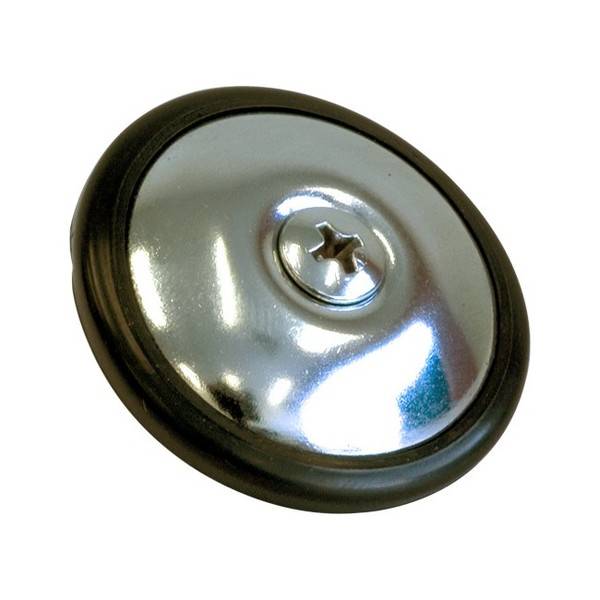

No A04 code. I am tempted to put a radio in it, but I’d actually prefer the novelty of the radio delete, especially if i can confirm it really was that way from the factory. Plus going with a restored radio, new speakers, wiring, etc that would match my restoration would be a lot more costly. If I want tunes I planned to put a Bluetooth speaker between the seats. That said I don’t feel really good about welding on a beautifully painted, perfectly good fender. So I’m really on the fence.
https://www.radioparts.com.au/produ...aerial-hole-cover-plug-sealoplug#.XJWeVbh7m70

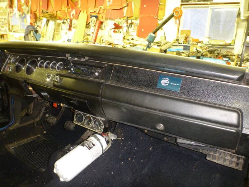

If there's a speaker in your dash and a hole in your fender it came that way from the factory. Nobody later in time was going to get up in there and install a chrysler dash speaker, in the 70's / 80's they would have slung tweeters under the dash edge and the good speakers in the back deck! .. don't ask how I know.. LOL
Good point. The fenders are new, but my old one had the antenna hole too. Plus it is an original looking mopar speaker in the dash. Unless it got installed at the dealer, I don’t see how it got in there either.
