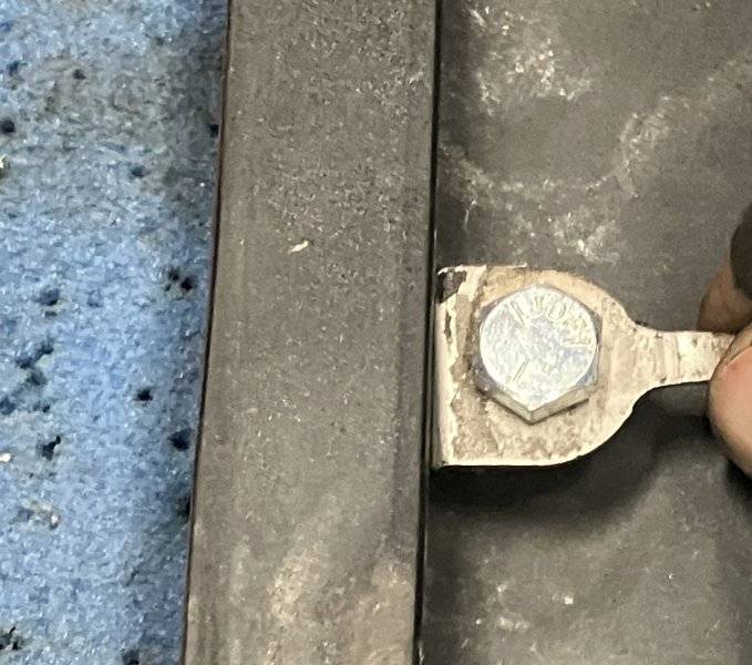

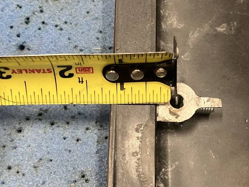

One last thing to do for these corner pieces. There are three metal clips that have to go on the sides to hold the panels tight to the body.
I just have to pull the corner cladding pieces and measure down from the tape to the flanged edges.

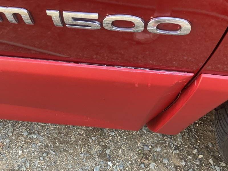

Here you can see a gap the will be closed up with those tiny brackets in place.
I measured 1 1/8” from the top of the panel to center of the hole for the bracket.
