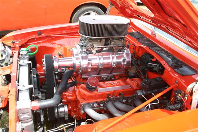

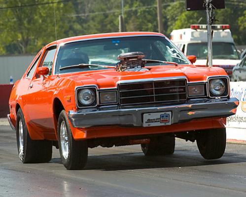

Neither will hook on the street anyway. My 3900lb Volare runs 11.0 in street trim. 340, factory heads, .540 lift cam. It runs a 6V-71 which is even smaller than a 6-71. The clearances are huge, no strips, 9% over. We've run a worn out 6-71 3% under on a stock 440 with a Mopar .557 cam. 3000lb GTX 5.90@115 in the 1/8 shifting at 5000. It doesn't take much.
Doug
