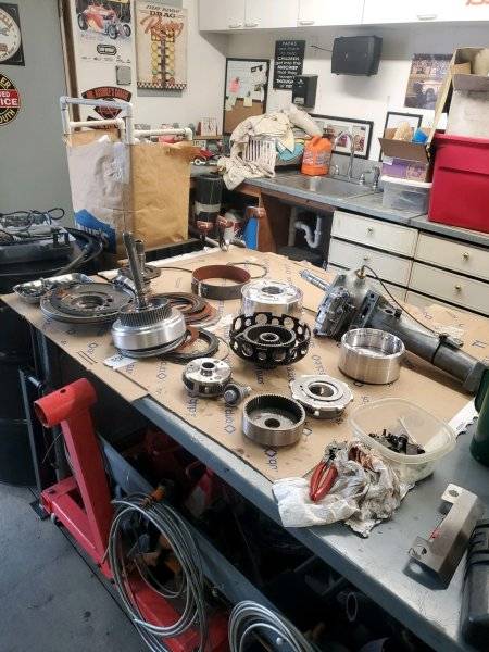

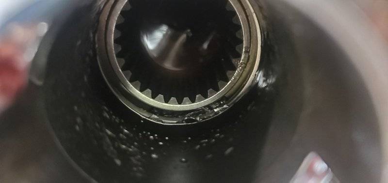

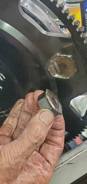

Got it apart yesterday. The pump housing and gears are scored a bit from metal. They'll be replaced. The torington in the conveter is toast. It also broke one mounting lug off the converter. I have a spare conveter.

Damn! Lot of expensive looking stuff right there. I imagine you can reassemble that with your eyes closed.

So what do you think was the main cause of failure?

Broke off a convertor lug. That sounds pretty bad. What would cause that? I know you have no problem doing the internals. But fix broken stuff & back to racing.

Wow, the bolt lug breaking off....that seems to be the trend. John Rendes had the same thing happen. What do you think caused that?
