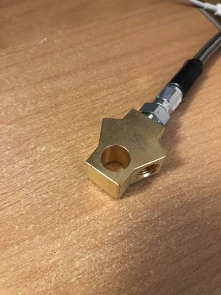

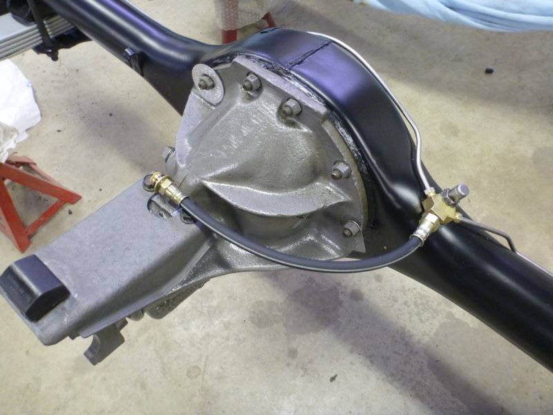

Can some one tell me what type of bolt (more specifically what head type) is used for mounting the rear flex brake line Y distribution block to the axle? I have to feel for it and can't see it.

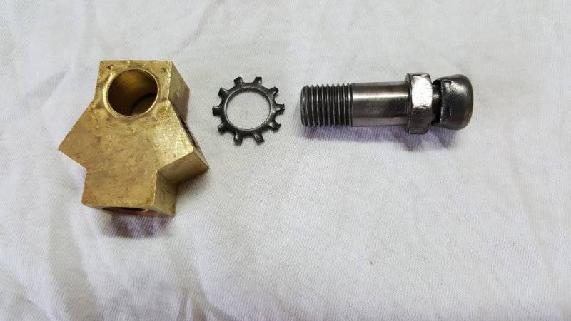

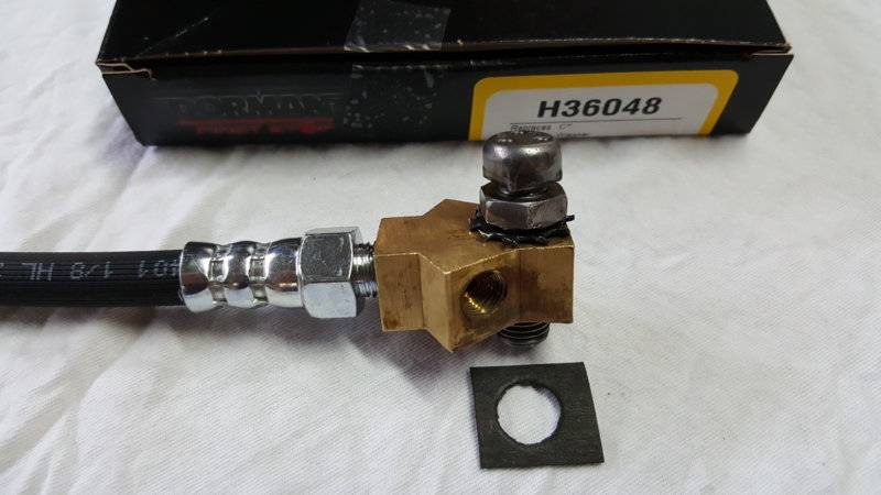

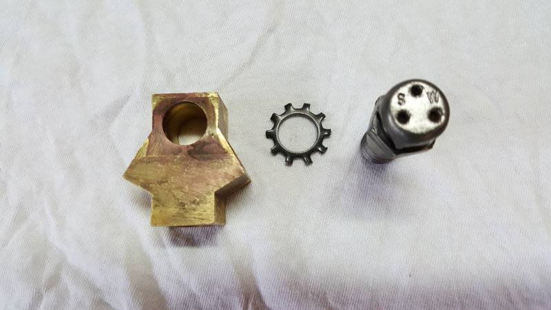

I found a paper gasket under my original block. I guess thats an option. I made a new one out of gasket material.
Thanks guys. I don’t recall feeling a vent type bolt. When I get back under her I will see what it is but at least I know what it should be if its not.

Is there for sure a gasket that goes between the TEE and the axle?
