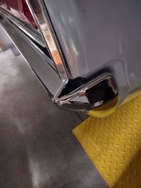

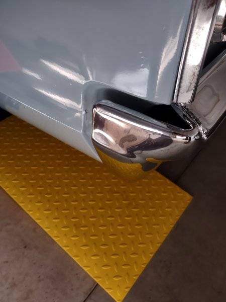

When I replaced my headlight wiring I had to drop the front bumper, and I was able to re adjust it and get it pretty close. I am looking at my rear bumper and it sticks out about an inch further away from the trunk on the passenger side. Looking at the brackets I don't see any in and out adjustment. Would I have to add shims between the body and brackets?
Just thinking. Maybe the bumper has a twist in it.
Did you look to see if there are stiffener plates behind the bumper?
Could be possible. There is a bit of a tweak beside the drivers bumper bolt near the licence plate.
An inch is a lot of twist not to be noticeable we'd probably even see it in the photo. Crawl under and look at the rear crossmember to see if its been punched in on one side.
An inch is just an estimate. You can sort of see in the picture that the bumper is higher and closer to the body on the drivers side. I will check the brackets and get some better pictures tonight when I get home.

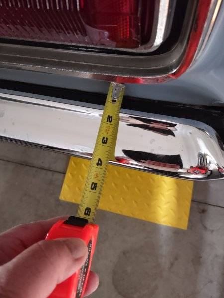

I measured and the difference is actually half an inch.
