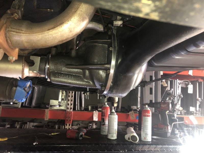

I wanted to circle back to this. It started with a choice but this is ‘MERICA , so I did both. My usual ready, fire, aim logical thought sequence. Oh and while your in there, new shocks, add drain plug to the housing, scrape some crud and give the housing a Craig’s list rattle can rebuild, sorry lost the receipts
I’m wrapping it all up and haven’t even bled the brakes yet. Also waiting on a bracket for my ebrake cables. It got lost during a subframe connector install- another truly ‘MERICAN moment. And i can’t believe I’m turning into one of these guys but now I HAVE to remove and wire wheel the exhaust clamps because my new bling blings make that rust really stand out.
