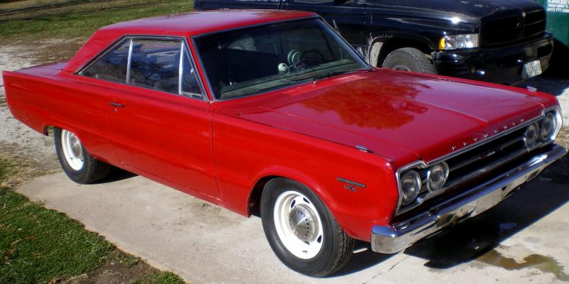

thanks to everyone who has helped my son and I build his dream car. we are approaching our one year anniversary on his 67 gtx clone, 477 dual quad stroker, race fuel street car. finally got it eatin' pretty good. it seems clear with this many horses our 4:10 dana is way to low for any pleasurable street driving. mini tub with 8 inch street tires provides almost no bite. If you pedal it a little only in first gear for about a second. and second just a little longer. Seems like if we did try to run a quarter mile we would be up against the rev limiter on the big end. thanks. BTW kevin got to drive it for the first time last month, on his recent trip home, lets just say he had some fun. thanks...Bob IMGP0213.jpg
