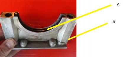

Hey guys, I have replaced my rear main seal 5 times now, I have tried 2 billet mancini styles, 1 440 source style, and reused the stock one twice. and have always had the pesky drip, and yes they are installed correct way around and no it is not leaky from anywhere else, I have checked the oil galleys in the back and the oil pressure sender location and all dry.
I have the sump off again and going to try and stop this leak once and for all.
my question is what is the best way to do this and whats the best type/brand seal to use. Where is the best place to use the RTV silicone?
Do you put silicone is item "A" the cup where the seal sits?
Do you put silicone down the sides in "B" where the side seals sit?
I am going to remove the 5 main bearing holder so I can get some rtv on the join between the block and seal holder as well. I am using arp main studs so I have to grind a groove out of the seal holder as well.

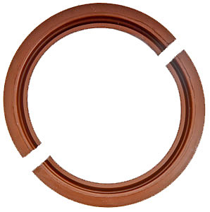

Using the shown seals (not the rope type), try the super black rtv, thin coat only on the outer diameter of the main seal, where each half fits into the block and cap. Before installing the cap, thin coat of rtv on the ends of the seal in the cap.

Not sure what to tell you on the side seals. The oil-swelling type was from Mopar, but came in many gasket sets. But...that was then...not nowadays. Guess it depends on who you buy from.
I found installing those side seals, to start them partways down. When you push the retainer into place, the side seals will 'slip' up as the retainer goes down. Just practice to get them where they need to be...need to seal at each end of the side seals, too.
I have had good luck with the orange rear main seals from Superformance and Fel-Pro.
I put a little smear of RTV in the seal grooves and just slightly offset the seal at the mating surface. Then I run a small smear of rtv across the block/cap mating surface, and leave a bit in the corner of the block. The Seal kit I use has the silicone(?) side seals which take a bit of time to work them into position.
With all the issues you have been having, Make sure to inspect the crank seal surface, and the block to cap mating surfaces. Note that there is no seal or gasket where the block and seal retainer end meet, so as I mentioned earlier, a very small amount of RTV to seal any surface imperfections.

After replacing that many lip seals I would do the rope seal and not look back. I have found some of the blocks are not machined concentric to the crank. The rope seal will allow for this. Rope seals can be difficult to install in the car but the Sneeky Pete tool is the only way I know to install them. Dropping the crank helps a bit. As for the side seals, I have been packing the groove with the "Right Stuff" sealer, then installing the retainer. I pack the outside of the retainer with a little more at the groove. It`s a lot harder with the engine in the car though. I use a small (thin) putty knife to get it in there. It looks good and never leaks. Goodluck Benno! I always like reading your posts!
